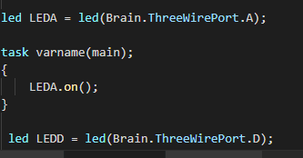

How to Program v5 Led Lights

You might do something like this:
led <name> = led(Brain.ThreeWirePort.<port_letter>);
task(main){
    <name>.on();

Mr. TaranMayer your suggestion did not work. Do you want me to show you the errors that occur when I types in your code
Sure…
@bossasawsome272 go ahead and post it
Nevermind I figured it out. What I did was use your code and then created a variable. I mean that is probably one way to do it. I am going to try and compile the code and see if it works
If you don’t mind me asking, could you post the code you had anyways?
Yeah sure give me one second. By the way the code worked
I made some edits and you were right most of your code was correct
Uh, I just looked through the project you sent and… you definitely need to go learn actual c++. That was painful to read.

He defined autonomous() inside the main loop

Respectfully, your code shows the opposite of what you intended. I strongly suggest that you go though some basic C++ tutorials before continuing to program your robot. It will greatly benefit you to properly understand C++ concepts when you go to debug your code and made it do what you indended.
