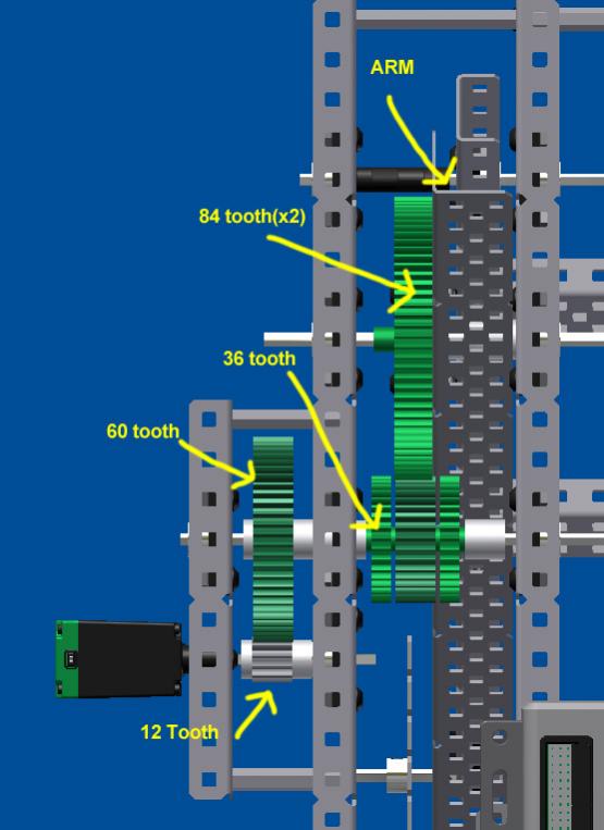

This is my 2nd year teaching robotics and this is the first year we will be competing in Vex Robotics… Gateway. All we have are 269 two-wire motors and external controllers. We are going for the tread system. The tread on two sides and hoping to get the spheres and cylinders that way. I have been watching TONS of video but still confused on how to get the “arm” up to get over the goals. Any suggestions, tips, ETC? I have a zero budget (Thank the Lord for donations) and do not have tons of parts. The students and I need some help.

I am waiting on high strength chain…I have tons of sprockets and gears. I have seen several videos and have some sort of idea. Do I put the little sprocket to the motor and the larger one below for more torque? I haven’t messed with stuff like this much.
Well, here’s an example from last years roundup robot which used a 4 bar. Not necessarily the best design (in fact there were problems with shafts twisting) but it shows the principle of increasing torque from the motor at the expense of speed. This just shows one side from behind, the other side was the same.

And from the side with the motor and some of the structure suppressed.

been doing vex for 4 years now and every time i go to build an arm i just revisualize that a big gear power a small gear would make the smaller one spin faster and you want strength not speed so flip it
motor on smallest gear
arm on biggest gear
for highest torque then you get into 2 and 3 stage gear reduction like that one is a 2 stage
In that compound gearing of 1:5 then 3:7, you would want to flip the order, so it goes 3:7 then 1:5. That way there is about half (7/15) of the torque on that middle axle, so you will be less likely to twist axles and slip the gears.
