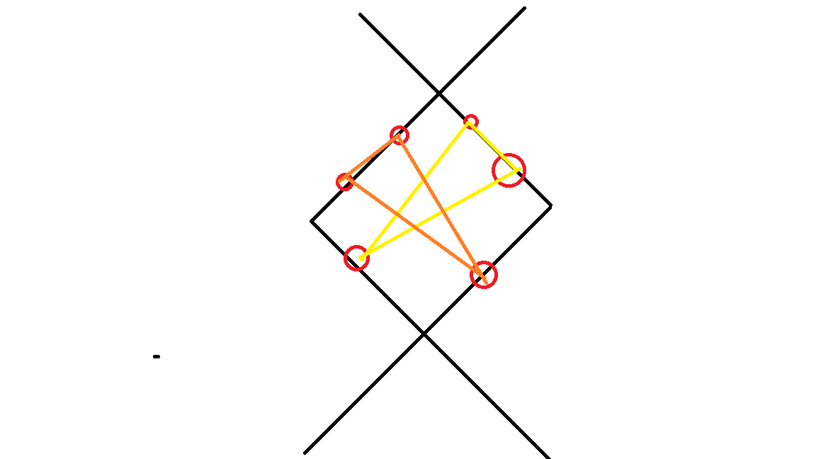

The point of triangle banding is to keep a constant tension for the entire lift up and back down. That being said, I think the best way to accomplish this on a scissor lift would look something like this:
The attachment points being the red.
I know historically teams in Skyrise would put bands between the moving/outside joints of the scissor lift. I would just make sure that it doesn’t cause any bending or flexing. Triangle banding the way that @SkinnyPanda Robotics said will actually pull it down and up effectively doing nothing. I would stick to banding in lines unless you need a triangle to tension it.

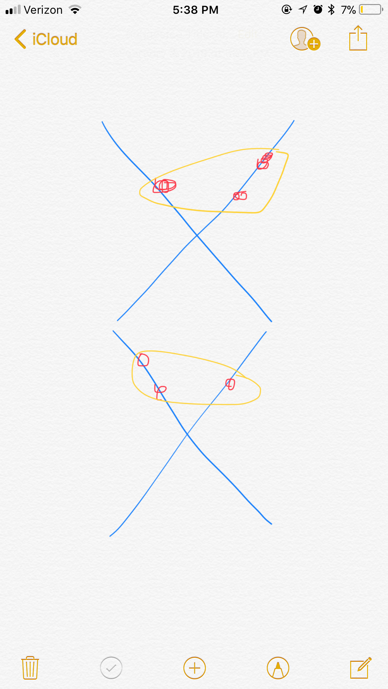

Hmm I see what you mean… would this work @Zach929Y ?
Probably but i doubt that it would do much compared to the horizontal one.
Literally thought the same thing.
How about this?
Perfection.
Okay I sense a definite bias…
Also, like that the triangles would perform exactly the same as straight lines…
I might be wrong but i think he was joking, and so was I. That would pull the lift down, i still think a line between the joints is the best option.
