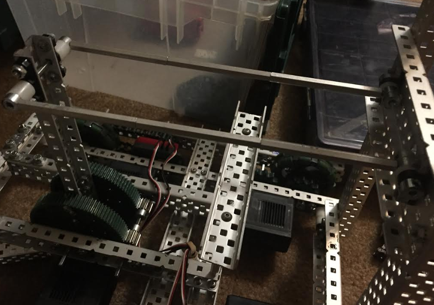

I’m trying to use couplers and standoffs to make the tray “tilter” and I’m not sure how to secure them. There are drive shafts on both sides, so I can’t just make them automatically tight. Any advice?

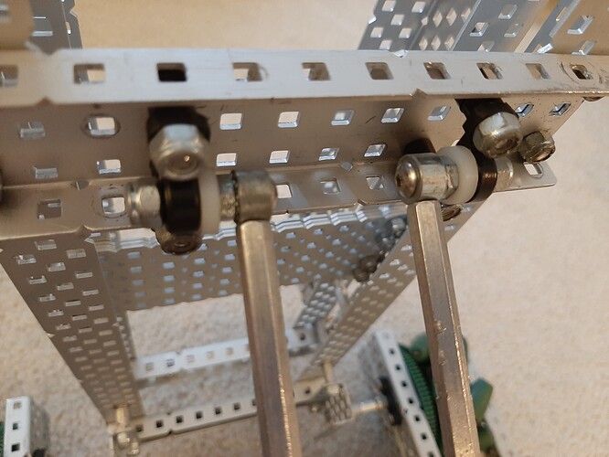

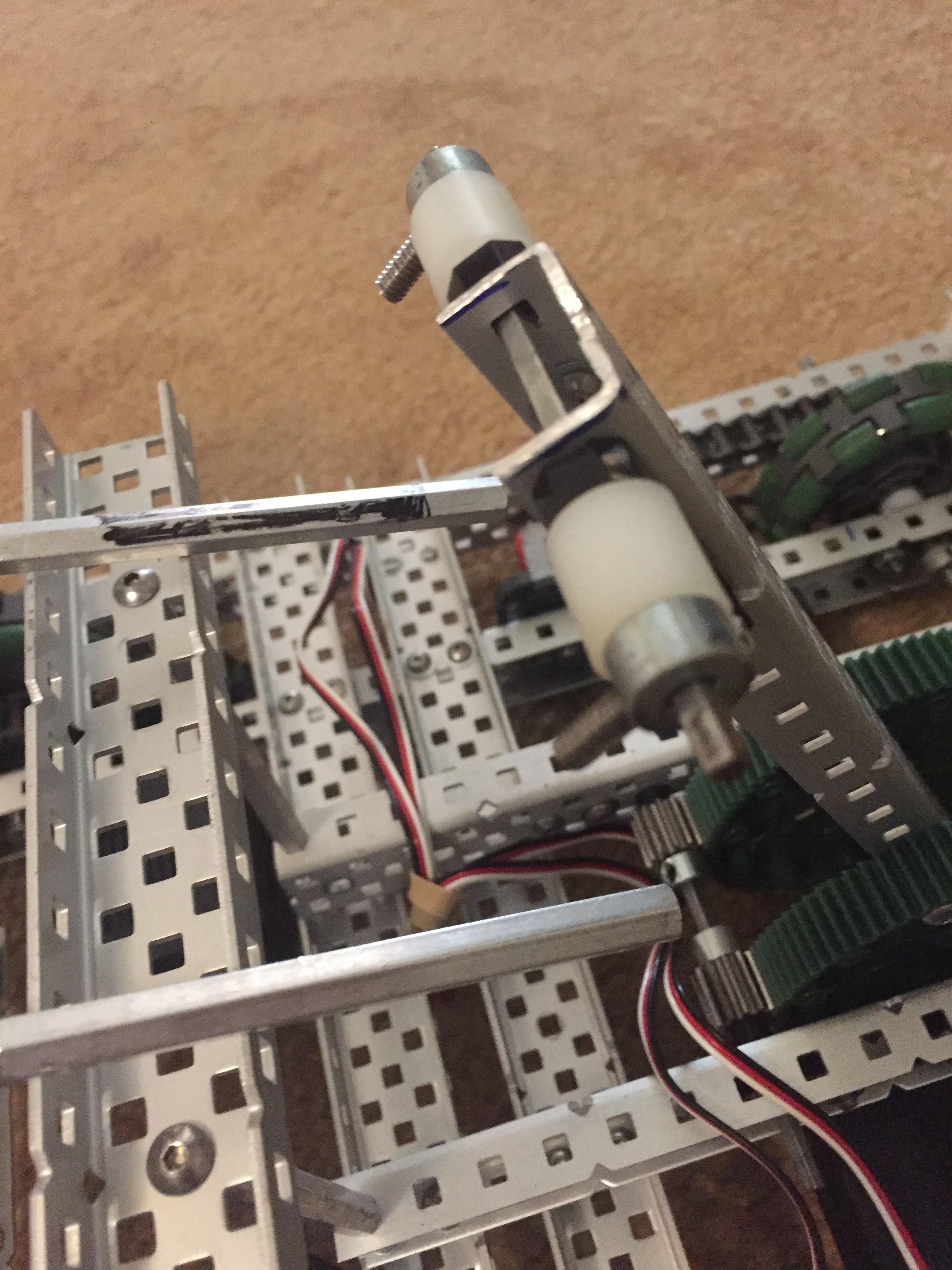

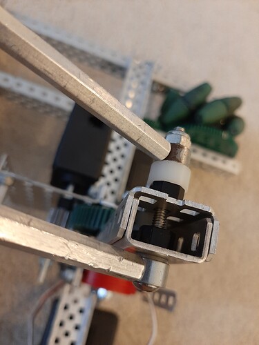

Put the shaft collars on a screw joint rather than a shaft joint.
20190921_114026
This way you can tighten the nylock to the point that the shaft collars are loose enough to rotate, but won’t be able to move around. You may want to drill through the holes in the shaft collars slightly to make them easier to work with. You should also use screw joints where they connect to the tray.
