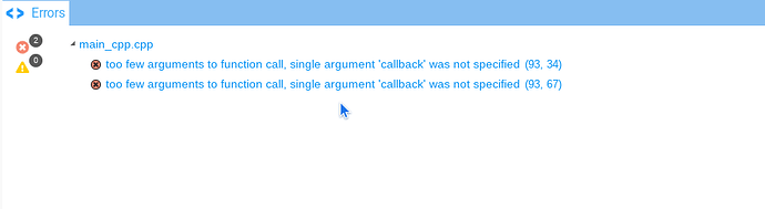

I tried just doing one function like this to test it before i go all- in and it had some weird issues building.
/*    Module:       main.cpp                                                  */

while(true){
if((Controller1.ButtonUp.pressed())&(Controller1.ButtonUp.pressed()));
NW;
Screenshot 2021-03-17 10.50.18
You need parenthases on your method call
NW();
Also, you need to use .pressing, not .pressed on your if statement. .pressed is only used for callbacks, which is not what you’re using in the if statement

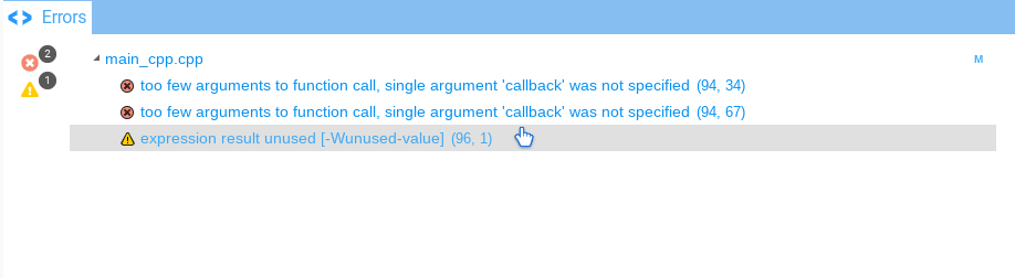

Tried and got this result.
One less error thankfully but still has a couple.
Screenshot 2021-03-17 10.53.12
I edited the previous post. See that
It built with no issues now, just need to test it
thank you for the help
