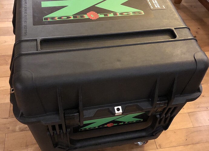

We use a Pelican case. It’s padded and protects the robot. There is absolutely no movement inside due the padding. We usually check it in while flying to competitions. The total weight doesn’t exceed the limit of the airline, so we only pay for a checkin bag to have it to follow us wherever we go. We will use the same system to go to Iowa for the US open from Canada.
