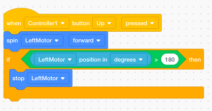

How do we intentionally stall a motor and detect that the motor has stalled? For example, we want to be able to move an arm or a forklift to its highest or lowest position… In FLL, we’d do that by applying power to a motor until its RPM reached zero. Does this paradigm exist in Code Blocks?
you can use a:
if…motor position=(degrees)…then_
ex. if leftMotor position=900 degrees, then stop leftMotor

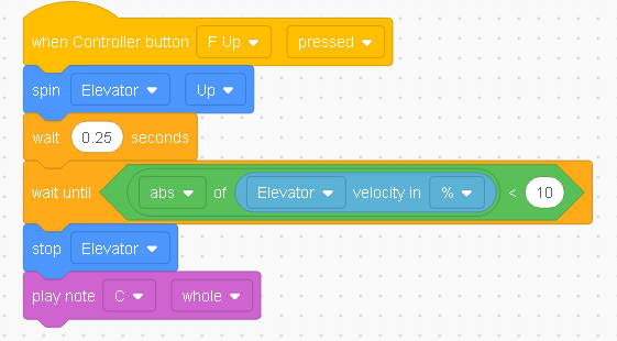

Yes, I know I probably got my terms mixed up. After some trial and error, I came up with this:
Do I run the risk of permanently damaging the motor? Is there a better way of doing this?

There is a distinct difference. OP is wanting to run the motor until it is stalled, often used as a way of detecting a physical limit.
You should be good, ideally you would reduce current (torque) on the motor when running this code, I forget if you can do that in blocks or not, but if you don’t keep sending power for too long when it is physically stalled it will be ok.
Reduce the torque before or after a stall has been detected?

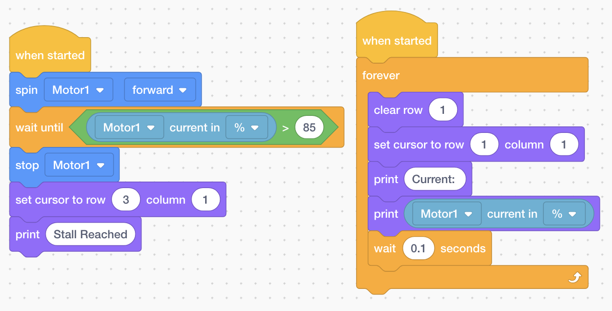

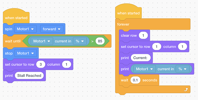

You could also see if the current on the motor “spikes”, indicating a stall condition. It’s not a 100% full-proof (i.e. if you’re carrying something heavy) but it can work for lightly loaded motors.
This example runs the “wait until current spikes” condition, but also runs a “print the current value to the screen” to help debug it as well.
