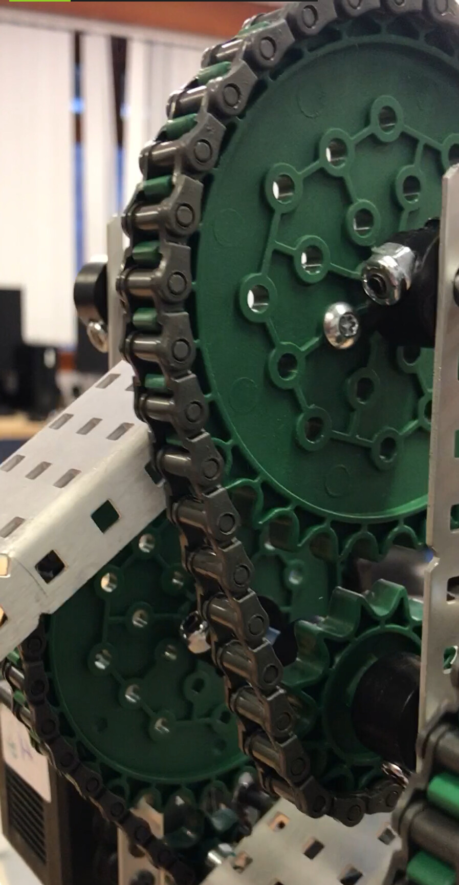

I am trying to lift a mobile goal using a sprocket and chain, as shown in the image. However, the chain keeps skipping over the sprocket teeth because of the weight of the goal. How do I fix this? I have tried tightening the chain but it’s not possible, and there isn’t any space for another sprocket.

The skipping is caused by the axles flexing away from each other. This will happen weather you use chain or gears. Two solutions are to switch to high strength axles, or to make the sides of the gearbox as close together as possible as they sandwich the gears or sprockets. The pieces I’m talking about being sandwiched can also be cross braced for added support.

If you can get a different angle of your gearbox I might be able to help more. I’m not positive but it seems like you might be missing bearing blocks.
They look like this, and help keep the axles centered in a square hole. They also prevent metal to metal contact, and keep the axles from pulling apart which is what’s happening when you hear skipping. You’ll want them anywhere an axle runs through a c-channel.
And if you do have these already I apologize, just can’t see them in the picture. If you don’t, add them throughout the entire robot! And do so before trying the solutions I suggested in my first post, because they may solve the problem completely on their own.
We currently do use high-strength axles for both gears, but not bearing flats as I assumed they weren’t needed for those axles. When I next get hold of the robot I will add those and see if the issue still remains (and take a better picture if it does). Thanks so much for your help! :slight_smile:
Np, theres a bearings with a larger size hole just for the hs’s.

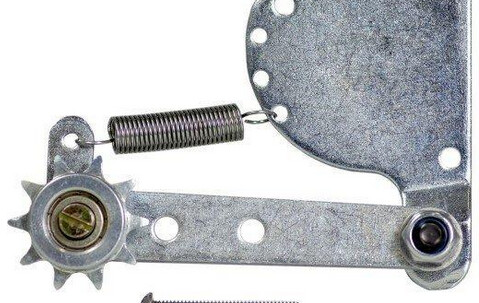

Add a chain tensioner. You could use a sprocket, or just a bolt with spacers on it acting as rollers. Bend a 1-by (flat steel) into a “U” shape to act as the ‘carrier’, then attach to a rubber band.
