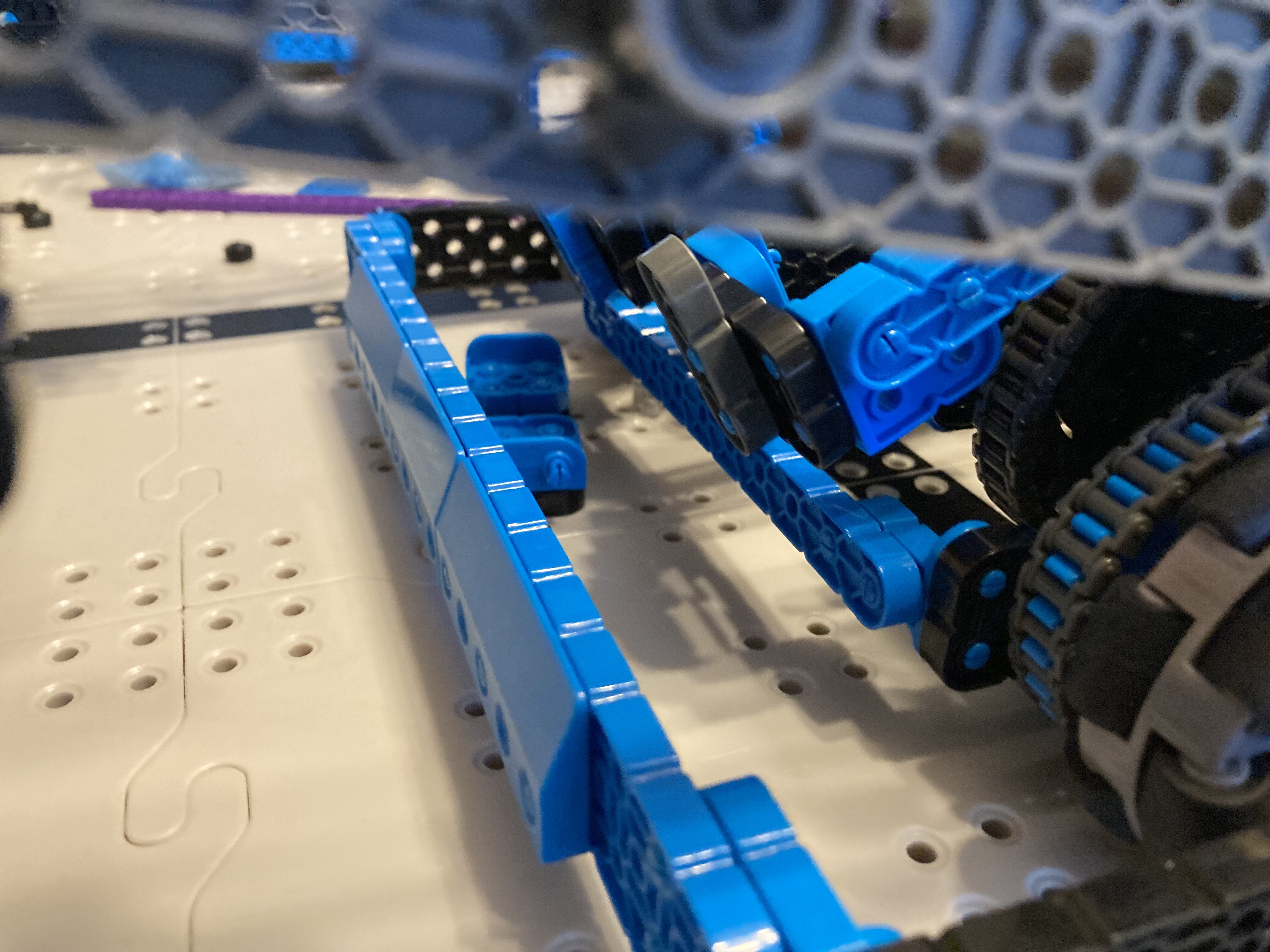

So I am having a bit of trouble strengthening my catapult mechanism. Every time I try to put in something to strengthen in, it gets in the way of the catapult itself.
Here are the pics
Just say of you want some more from different angles
The problem is that the beams behind the choo choo mechanism bend up because of the tension from the catapult rubber bands. This makes it inconsistent and it breaks easier

The two sets of gears bend up when the catapult moves, until the aforementioned beams break
Not sure if I’m interpreting this correctly, but if the black beams are being bent upward because of the rubber bands, there could be some opportunity to reinforce it on the other side, with something attached to the the blue 1x beam (or replace it and attach it differently).
If the issue is to do with the gears shifting along the shaft, I wasn’t really able to think of a way to reinforce that better, since the center area does need to be open (but there still might be a way!)
The problem is if I attach anything from the two black beams to the blue beam, it blocks the catapult on its way down.

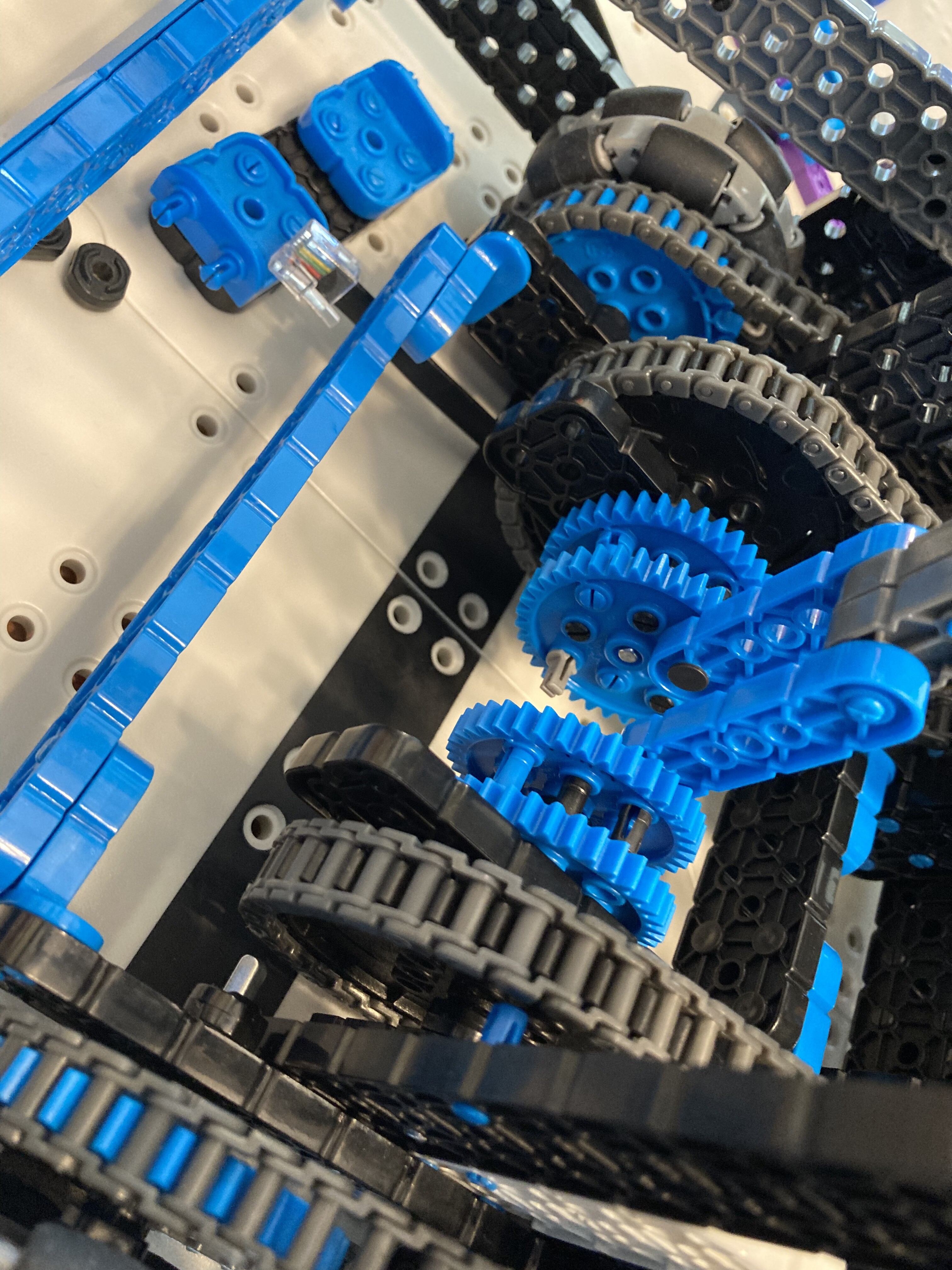

Do you have any pictures of the catapult in its down position?
Do you have a video of it breaking?
I couldn’t get a vid of it breaking, but here are pics in the down position, you can see how the gears and beams are bending as well
