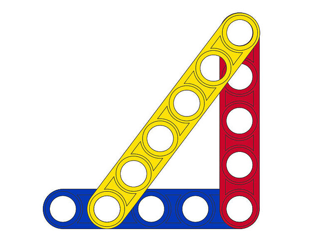

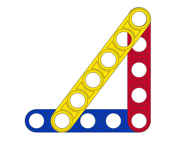

For my robotics class, which is moderate to low investment, I typed up a sheet of simple questions, like “Do you have your chassis rails connected by more than one piece of support? Do you have two bearings on every shaft? Did you use 3-4-5 support triangles to make sure your chassis is squared up?”
Wait chassis triangles? What’s that?
It is really easy to make your chassis some kind of parallelogram/trapezoid instead of a rectangle. This means that your robot will not drive perfectly straight and your geometry may be off when adding additional components and systems.
To prevent the chassis from winding up skew, you can cut a flat 1hx6h piece of metal to act as the hypotenuse of a right triangle. From where the chassis and cross-chassis bars meet, count 3 holes down one rail, and 4 holes down the other rail. You can then make a right triangle using the flat 1x6 bar. I know a picture would be easier, so try this out.
Oh that’s what it is! I got the special gussets for 90 degrees so I’ll use those instead.
