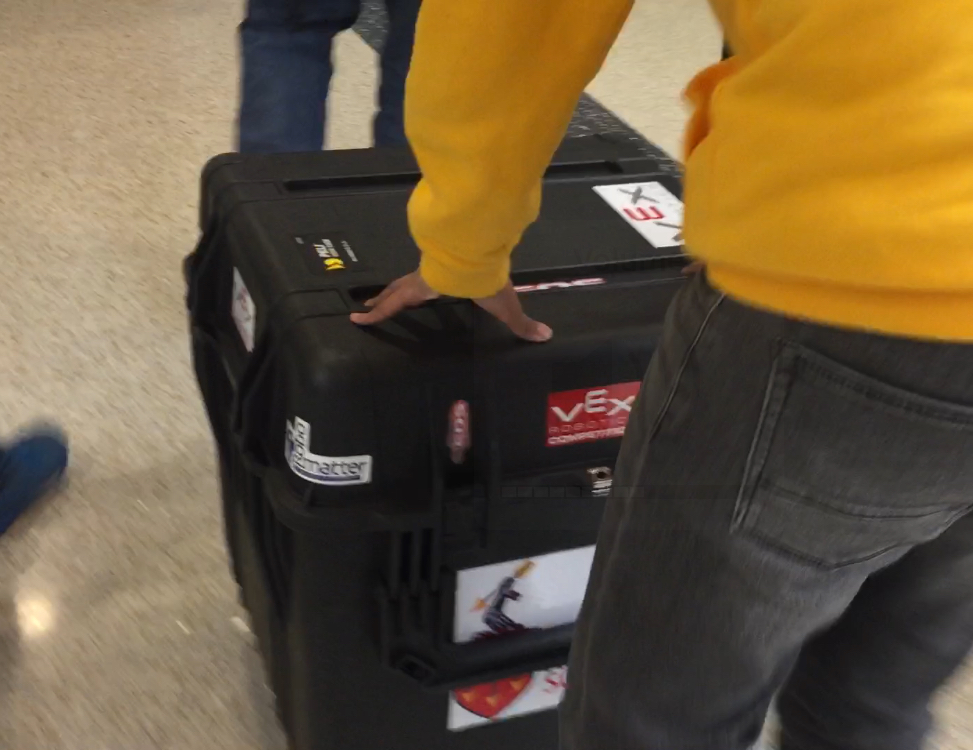

Hello, we used a flight case for worlds, this is like the only photo I have:
It was made of strong plastic, and costed around £500 (roughly $660). It had handles so we could pull the case around, and you could attach wheels to it. We kinda lost one of the wheels, which is why we didn’t use the handles to drag it around. There was plenty of room inside, so we could fill it with foam pieces to protect the robot on the flight (it went into the cargo hold on the plane). This is definitely a good option (but fairly expensive) for transport; however the unpacking process is messy, as loads of small foam pieces are left around and putting them back in the case in the correct orientation is a nightmare.

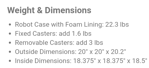

these hard cases are good with removable wheels they meet airline requirements for checking in as not oversized.
