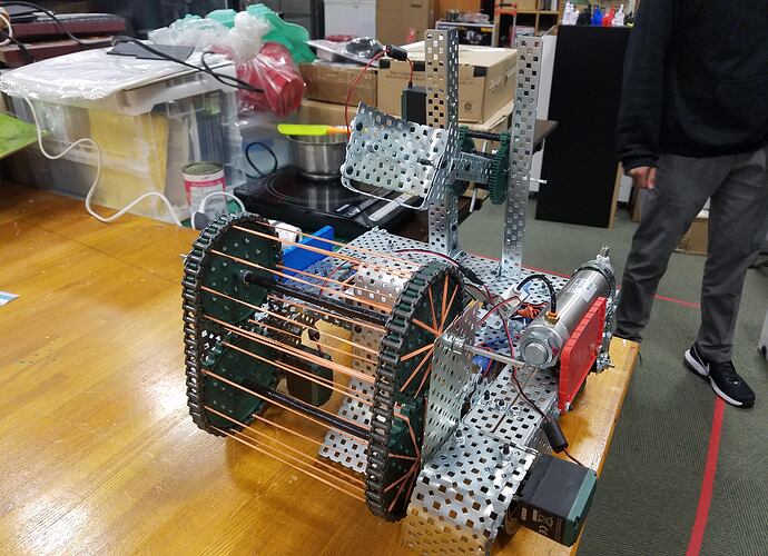

So we’ve been trying to turn over the caps using our intakes and obviously we’re making the intake go upwards so that it turns… but when we tried it in our hallway it didnt work because the floor was quite slippery… while it somewhat worked in our room which had carpet…
Since we can’t buy the vex field and its components like the field’s floor we don’t know how much friction the competition’s floor will be like and thus we dont know how to make sure our intake turning the caps will work…
What shall we do
how can we find similar real life material to the competition field’s floor?
should we add more rubber bands to the intake? should we even take it to the length of doing a goliath intake?
Should we make the intake go at a faster speed instead?
Any other ideas?

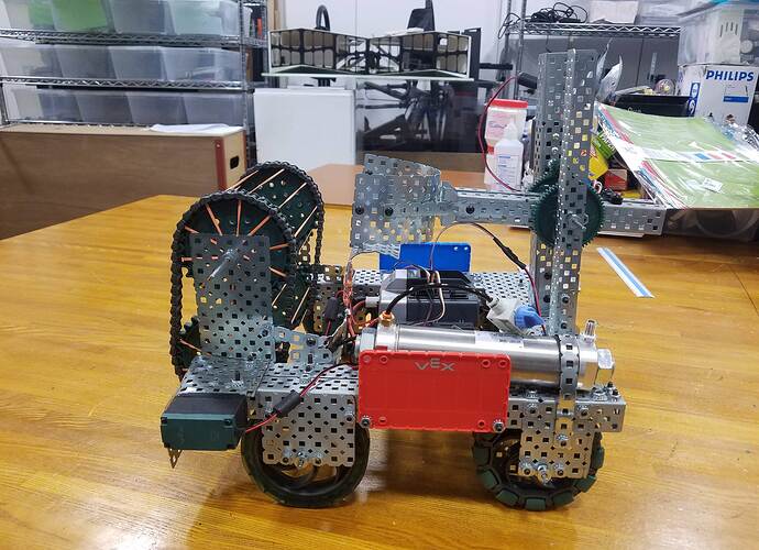

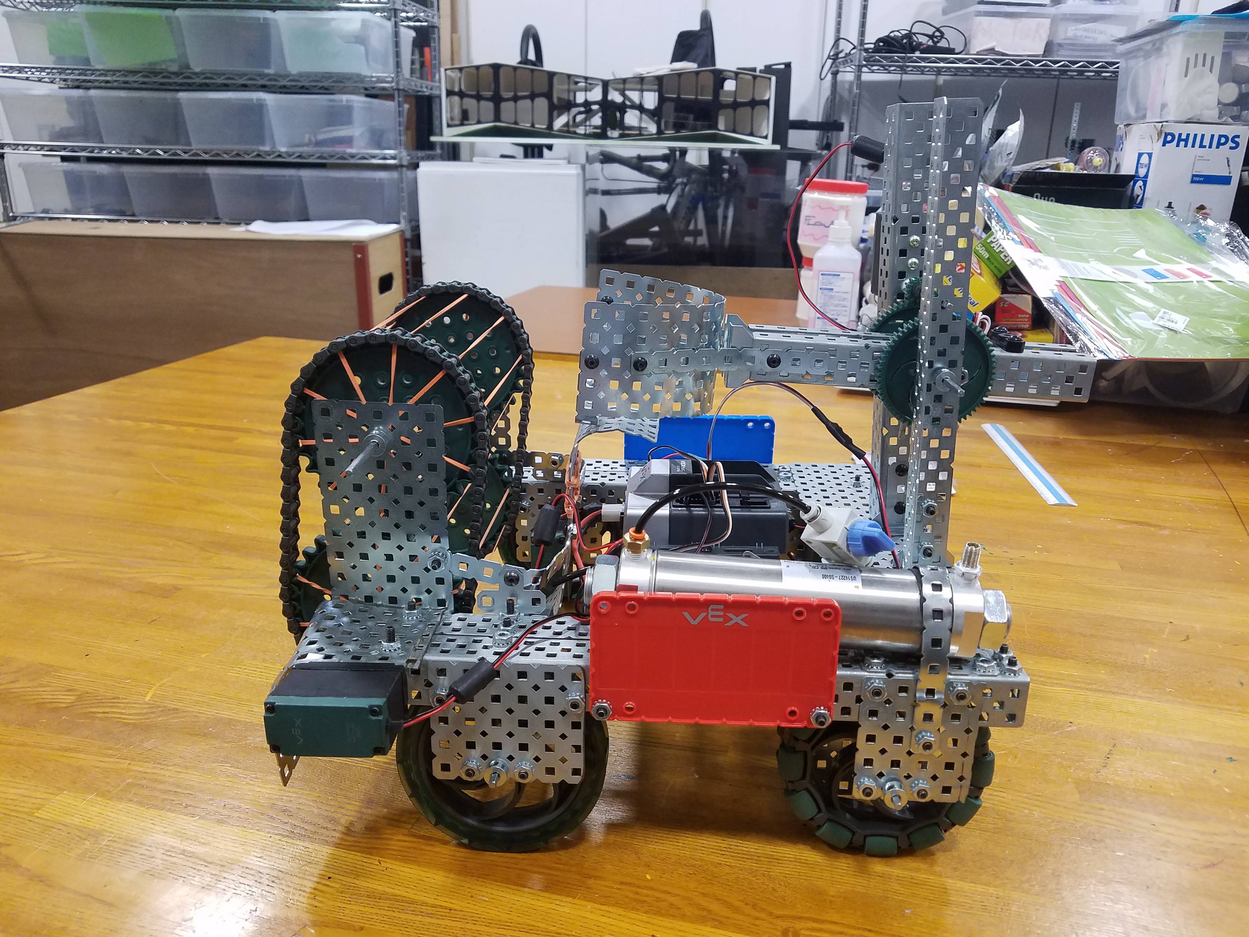

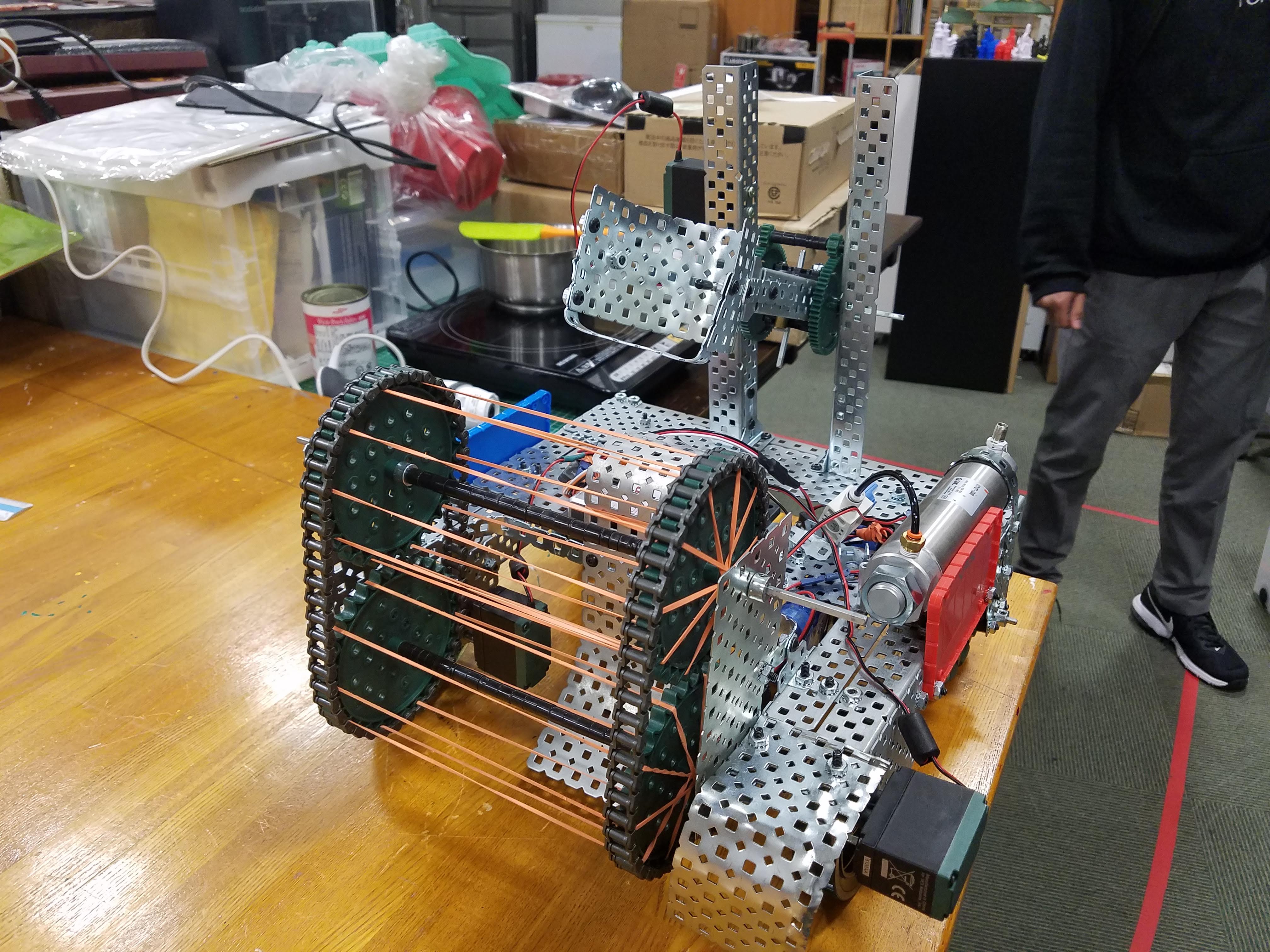

@Got a Screw Loose heres a pic
If I’m looking at it correctly, it looks like you’re straight shafting your motor to the lower roller. I’m not sure if that’s fast enough. But, if you can almost flip it on carpet, you should be fine. The best way to test it without the foam is to give the cap some friction. I just put my foot in front of it, then drove into it. If that works easily, you should be fine. But just in general, unless you have a turbo speed motor powering your roller, it may be nice to speed it up.
I’m not sure about the baby mats, but if they’re similar to Vex’s foam tiles, go for it. I’m sure you can find foam matting at a big chain store in your area.
