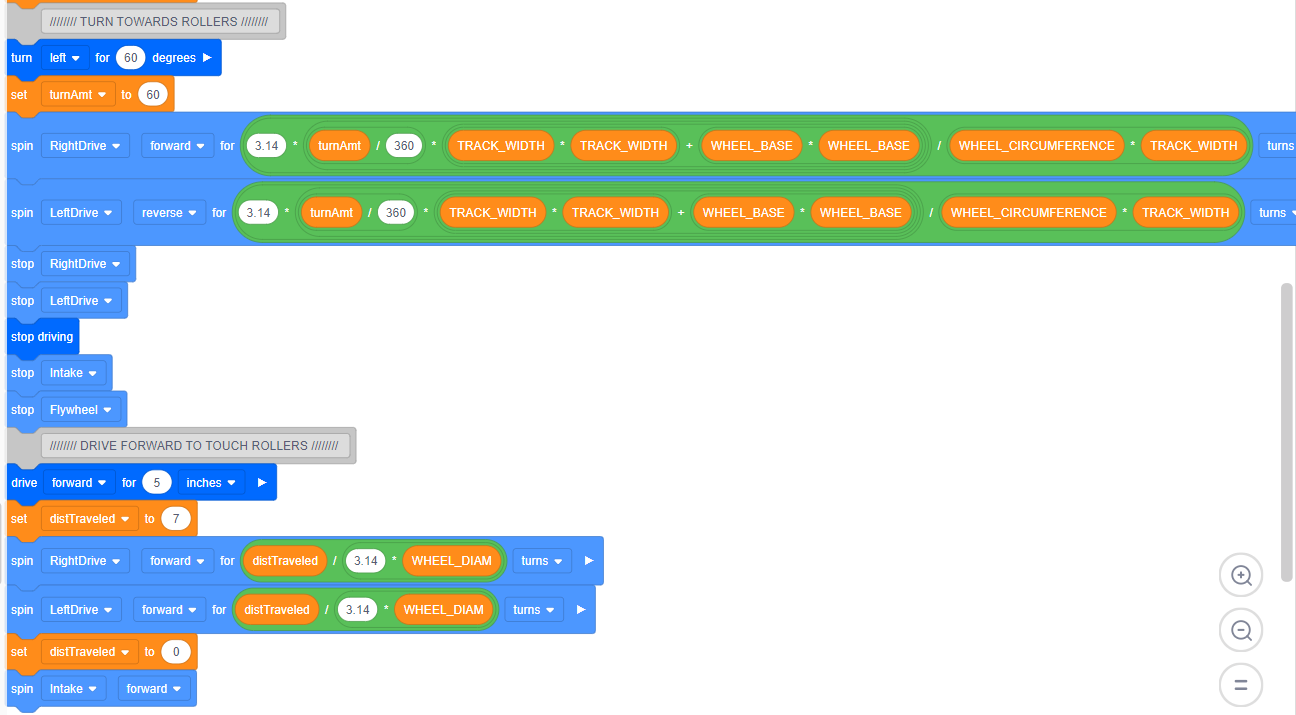

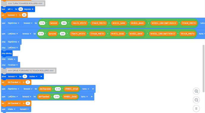

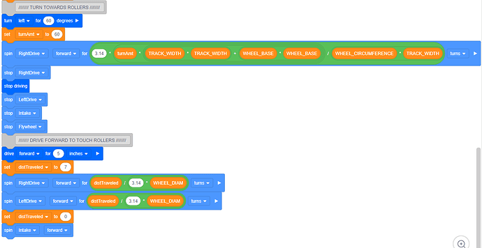

update: The turning works, however, there is still the sound of some motor running after the turn. Because of this, the robot isn’t doing the next series of commands, as it is stuck there.
I use 6 grey anti-static omni wheels, 1 motor per wheel. They are green cartridge
Edit: I found one of my mistakes in my code, but it still is having the problem stated above.
The issue is, after I turn, there would be some motor still running (I don’t know which one it is). This means that the remaining code after the turn does not run.
couple of things
turn left for 60 degrees
will block, use the and don’t wait setting.
(same with the first spin RightDrive command, only block on the last part)
you can actually simplify the calculation.
t, b, c and PI are all constants on your robot, just pre calculate all that part and assign to a variable.
