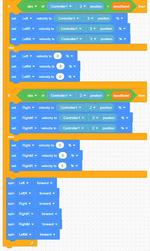

I’m trying to make a drivetrain with 4 motors but I don’t know how to make it use all 4 motors. Right now it’s only powering the back wheels. I tried to download the 4 motor drive from Vexcode but that didn’t work. How can I connect all 4 motors to the drive?
If your using code blocks you can do something like this. Note that this is for a 6motor drive so you just have to remove a motors form the left and right sides of your code. You also have to set all of the motor ports up individually not using any preset drivetrains that code blocks might have.

It did work thank you all for your help
