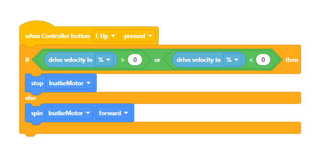

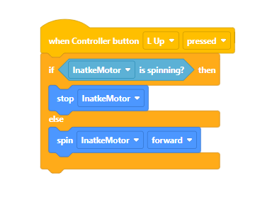

My students< who are all brand new 4th Graders, were working on programming a switch for their intake motor, so that they don’t have to hold down the button while they drive.
With some instruction they go to this
But that didn’t work, so eventually they go to this
Which works, but is definitely a lot more complicated to understand than the more obvious “is the motor spinning”?
Any thoughts on what we did wrong?

In picture #1 you have it set to “if IntakeMotor is spinning?,” but in picture #2 you have it set to (the equivalent of) “if drivetrain is moving?”
Did you mean to use drive velocity for the second conditional? It seems like this will only turn on if your drivetrain is still, and will only turn off if it’s moving, can you give more information on how the robot is behaving with both snippets of code?
The “Is spinning” blocks only returns true if the motor is performing a non-blocking version of the “spin for xx degrees” or “spin to position” calls. You would use it to test if the motor had reached its target position if the “and don’t wait” option is selected on those blocks. “Is spinning” is not used with simple “spin forward” commands.

Sorry, that second picture should have been using the INTAKE motor, not drive train. I was recreating what they had done to generate the screen shots. My bad.

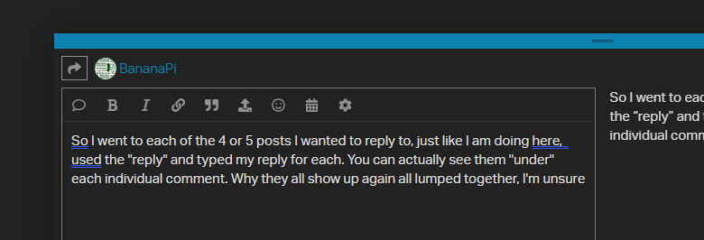

ChrisR246, please combine your posts into one post next time. If ou highlight the text on the post you want to reply to, ou can quote it, reply with whatever you want, and then repeat for the next post.
So I went to each of the 4 or 5 posts I wanted to reply to, just like I am doing here, used the “reply” and typed my reply for each. You can actually see them “under” each individual comment. Why they all show up again all lumped together, I’m unsure why they show up at the bottom as well
Sorry if I was confusing. I was jusst pointing out that you could condense your 4 posts into one post, helping keep the topic a bit less cluttered.
