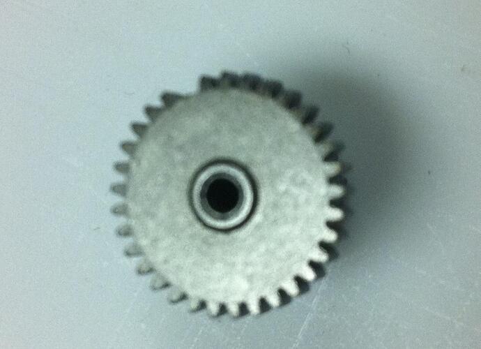

The smaller gear (torque setting) in our High Strength 393 motor lost a tooth. Has this happened to anyone else?

Actually, ours were because of a (somewhat) defective motor in which the plastic surface that the metal gear rested on was not flat which caused the gear to not mesh correctly with the others… It may not sound like much but when we compared it to another motor there was quite a noticeable difference in the smoothness of the rotation of the gears… It took us 5 broken gears to think “maybe it’s the motor?” when the other drive motors had never had a single issue once.
If this is the case, then this definitely qualifies as a manufacturing defect and we would love to get this one back. I will be in NZ for the Robot World Cup so get this back to the Massey guys and I will bring some motors with me to replace it.

In addition, for those of you who broke this gear on the HS motor, please tell me everything you can about the system and situation in which it broke. we have not been able to fail the HS motor in the manner in which you describe in this thread so really want to know what is causing this.
2:1 drive on 4" omnis (fast)
drive a full length of the field, and then suddenly jerk the joysticks full backwards
its insane gear ratios like that AND “poor” driving practices that gets the motors ending up like this…
We know better than to gear/drive like that :smiley:
We’ll try to get some photos taken of it to document what’s happening and send it along to vex technical support.
