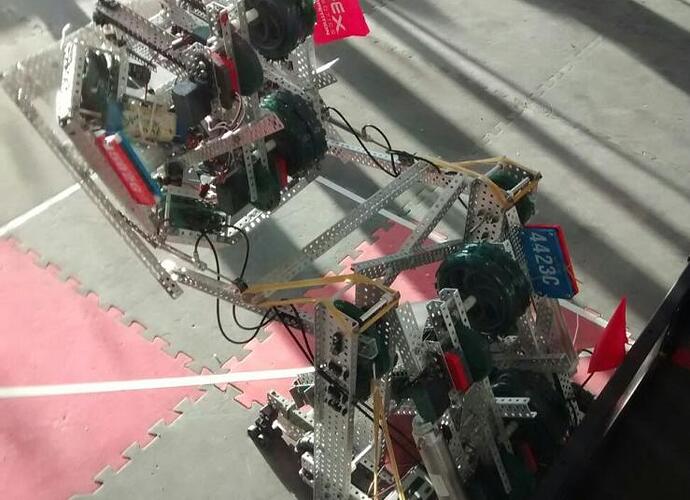

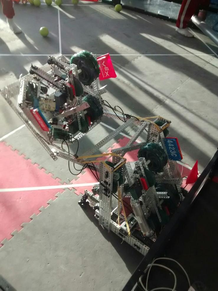

Specifications
4423C lifter robot
First hybrid robot reveal (as far as I know)
Flywheel
2 motors internal turbo gearing 7:1
5" wheels
Ramp
pneumatic actuated
less than 10 degrees slope
Lift
2 strength motors
Intake
2 high speed motors conveyor
Autonomous
4 preload in high goal (20 points)
4502G lifted robot
Flywheel
5" wheels
Intake
2 strength motors
high strength chain and intake rollers
Autonomous
3 preload in high goal (15 points)
100% accuracy
**drive **
8 high speed motors x drive

The total gear ratio is 1:147
We use pid whit a dynamic ewma filter (Exponentially Weighted Moving Average)
I mean is able to shoot and lift.

The code i use in both robots gives a great accuracy but also increase the cooldown a bit, it takes about 1,3 seconds so that the pid error is 0 steady.
4502G has the advantage of angle, almost 45, for the full court shot uses only the half motor power, is very unlikely to overheat even with two motors
4423C has a larger angle then uses more power, is proven to works fine in 2 minutes shooting 30 balls, then everything depends on the battery level
We use plenty of lubricant and only the necessary spacers
The wheels are completely together, we use two to have more force
force = mass * acceleration
The ramp is just under 18 inches wide and 4502G is 16 but almost any robot fits in it.
