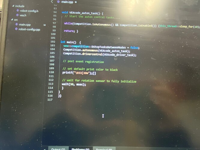

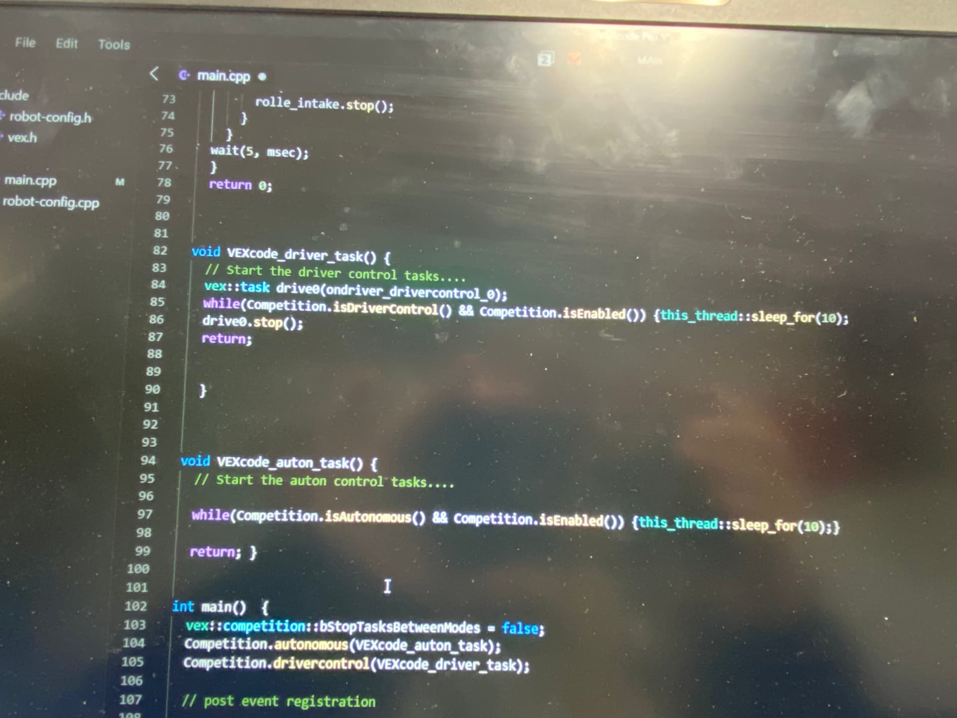

Here is the whole program

I don’t think the pictures got uploaded correctly, you mind just pasting the code into a reply? make sure to start and end it with ``` so it formats correctly.
Oh yeah sorry. I didn’t know I will be showing them soon.
It looks like you are missing a closing brace and an else
statement on line 65.
if (Controller1.Button1.Pressing(){
// ...code...
rolle_intake.spin(forward);
} //<-- Here
else if (Controller1.Button2.Pressing(){
//... code
else {
rolle_intake.stop()
