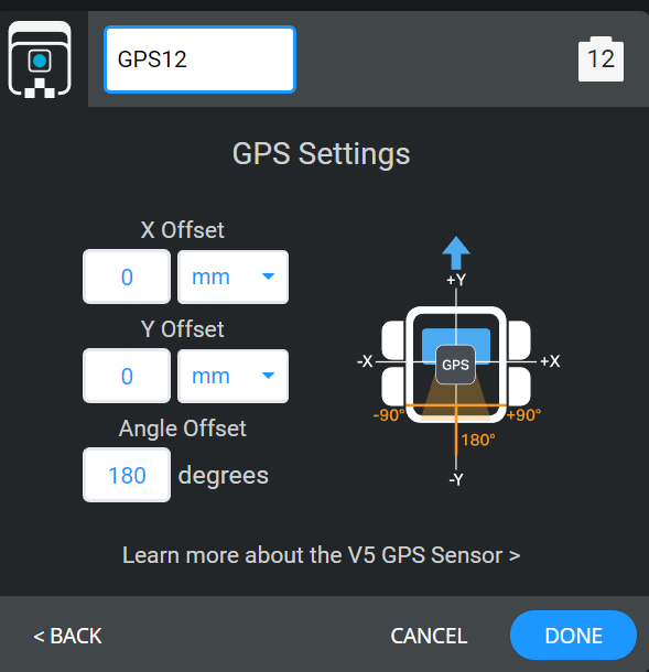

Me and my team want to use the V5 GPS sensor for our robots skills this year. I know how to put it in the code and how to put it on the robot, and how to measure the offset of the sensor, but I have no idea how to code it and everything I see for coding help is using block V5 code but I have only ever used V5 pro. I was wondering what should I look into to start and how do I even start the process of coding the sensor to move the robot to a location on the field.

just measure how much offset the GPS sensor is from the middle of your robot. Adjust it until you think the picture matches with your robot.
My guess is that offsets are so small that inches are not precise enough
