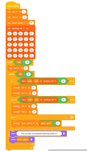

I have a program that doesnt work for some reason can someone help?
this is my code for now:
Please tell me if the code above shows up I was having trouble with adding screenshots. The goal of my code is for it to scan the 2D list(parking lot) and find a open parking spot which is 1:
0 = Aisle or road that can be traveled
1 = Filled parking spot
2 = Available parking spot
I need to use a conditional and print the variable open parking spots at the end.
Here are the reqs:
  • Create nested while loops and a conditional that scans the mapped parking lot list for open spots.
  • Use a conditional statement to tell the program it should increment the open_spots variable when it finds an available parking spot.
  • Include print statement at the end of your program to display the total number of available parking spots on the SDV’s screen. For example: The number of available parking spots is …
Thank you!
I made a mistake “Please tell me if the code above shows up I was having trouble with adding screenshots. The goal of my code is for it to scan the 2D list(parking lot) and find a open parking spot which is 1:” ITS NOT 1 ITS 2 sorry…
This is the code I have after waiting for it to get approved can anyone help me get it converted into blocks?
