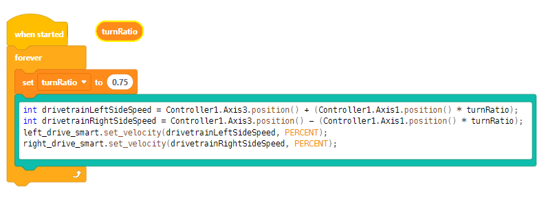

Hi. I have a four motor drivetrain, and I’m trying to code it in a way that both left and right motors go forward when you push just the left joystick forward, and backward and you push left joystick backward. For turning right and left, I want to have it so that it turns right when I push the right joystick right. Left when I push the right joystick left.
The reason I am trying to code this and not just use the drivetrain config is because I cannot set the turn or drivetrain velocity when I do that. I want to be able to set the velocity, while at the same time, have the control of the drivetrain config. I do blocks.

You can use the Switch blocks to override the joystick controls. The turnRatio variable allows you to adjust your turn velocity without affecting the drive velocity.
I can’t test this because I am not near a brain but it should give you the concept. Make sure that you are not binding the joysticks in the Devices page. Other devices can be configured but nothing that is being controlled with code.
