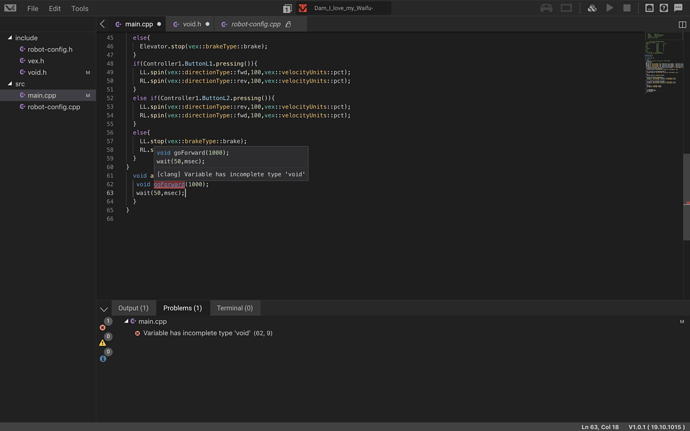

58 PM Screen Shot 2019-12-06 at 4.34.58 PM
Remove the void in front of void goForward(1000); on line 62. The line should read goForward(1000);
