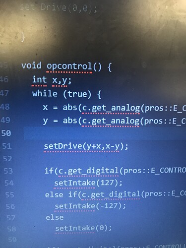

it is show the red under line and it will not download to the slot and we are rookies to vex pros
We are bad at this there is a lot more to just that it is all through our code

I suggest you log into the forum on the laptop you are using to write the code. It’s very difficult to debug code without being able to (a) see the entire program and (b) edit it to correct any errors. Photos of a screen do not enable either of these features.
#include "main.h"
 pros::Controller c(pros::E_CONTROLLER_MASTER);
 pros::Motor DriveL(6);
 pros::Motor DriveR(7);
 pros::Motor IntakeL(1);
 pros::Motor IntakeR(3);
 pros::Motor Placer(5);
 void setDrive(int l, int r)
	 DriveL.move(l);
	 DriveR.move(-r);
 void set Intake(int p)
	 IntakeL.move(p);
	 IntakeR.move(-p);
 void setPlacer(int p)
	 Placer.move(p);
void initialize() {
void disabled() {}
void competition_initialize() {}
void autonomous() {
set Intake(1000)
pros::delay(1000);
set Drive(127,127);
pros::delay(1000);
set Drive(127,127);
set Drive(0,0);
void opcontrol() {
	int x,y;
	while (true) {
		x = abs(c.get_analog(pros::E_CONTROLLER_ANALOG_LEFT_Y)) > 5 ? c.get_analog(pros::E_CONTROLLER_ANALOG_LEFT_Y) : 0;
		y = abs(c.get_analog(pros::E_CONTROLLER_ANALOG_LEFT_X)) > 5 ? c.get_analog(pros::E_CONTROLLER_ANALOG_LEFT_X) : 0;
		setDrive(y+x,x-y);
		if(c.get_digital(pros::E_CONTROLLER_DIGITAL_L2))
			setIntake(127);
		else if(c.get_digital(pros::E_CONTROLLER_DIGITAL_L1))
			setIntake(-127);
		else
			setIntake(0);
		if(c.get_digital(pros::E_CONTROLLER_DIGITAL_UP))
			setPlacer(127);
		else if(c.get_digital(pros::E_CONTROLLER_DIGITAL_DOWN))
			setPlacer(-127);
		else
			setPlacer(0);
		pros::delay(20);
if you could help that would be awsome
Function names (such as setIntake, setDrive, etc.) can not contain spaces.
Modify instances of set Drive, set Intake, etc. to remove the space.

when i took away the space the red line popped back up
I suggest you try to compile the program and see what happens. Red underlines don’t indicate program error, it may just be a spell checker complaining about something.
If your program fails to compile, please post the complete error you receive and we can help you further.
