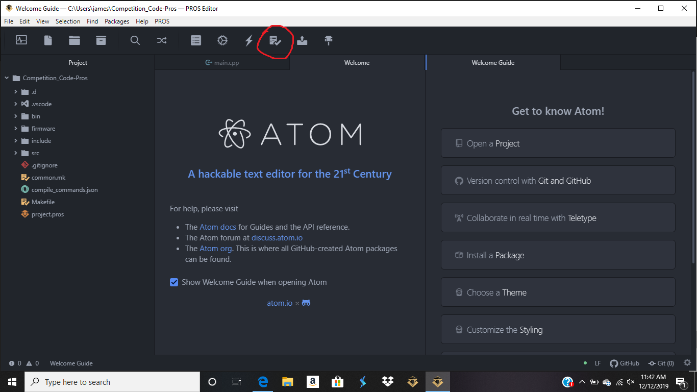

That… is not a compilation error. I’m not super-experienced with the PROS editor but that appears to be some menu text.
I suggest you implement the fix @Codec and I have pointed out (remove spaces from function names) and try to recompile the code, then post the error text you get (if any).

Sorry I keep forgetting, in pros the button is labeled build. The red circle shows the build button.Screenshot (24)
