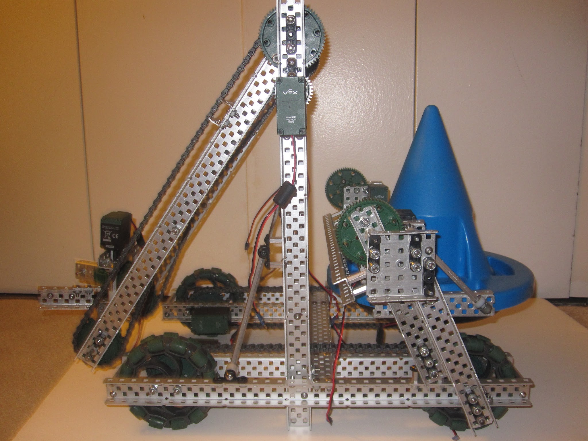

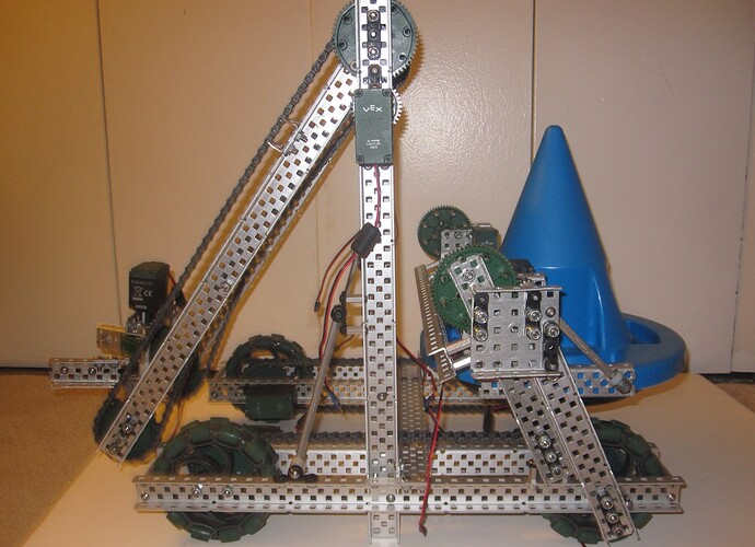

So on my robot, I’ve made the mistake of not leaving enough room for the mobile goal lift. My robot has a chain-bar that will lift the cones, swing around, and place the cone on the mobile goal; or it would if I could lift the mobile goal onto the rear of my robot. I have about 5-6 inches to work with. The robot top of the back of the robot (the point i need to get the MG to) is about 4.5 inches off the ground. This is a huge challenge and would really appreciate some help. I’ve looked at different types of lifts and it seems like its impossible to do it, but I know it is and if anybody knows how, it’s the forums. PLEASE HELP!

My robot base looks like this from the front:
||____||
with the wheels in between the upward parts. so the gap in between the 2 inside upward parts is where I need my MG lift to be, unless you have a better idea. So far I have nothing as far as the MG lift goes. I have a really-close-to-being-finished chain-bar that will use the mobile goal to stack on when it is lifted.

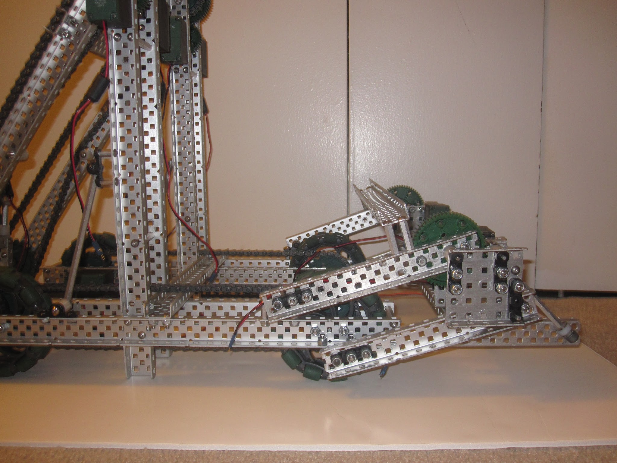

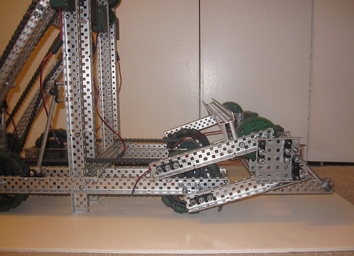

Not sure if this is what your looking for but: (motors are on the other side of the 60 tooth gear)
Another alternative that uses virtually no space at all is mounting the pneumatic pistons vertically and having them power the mobile goal lift.

A number of people are using something like what AG256 posted. You can put the 4 bar in between the sides of your chassis and shouldn’t have to rebuild anything
