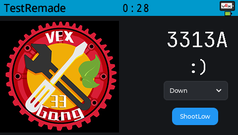

Snaoshot
If I don’t use gif, it worked out pretty well. However,when it comes to gif playing.I screwed up.Even if I change the lv_conf.h ,the gif just can’t be played.

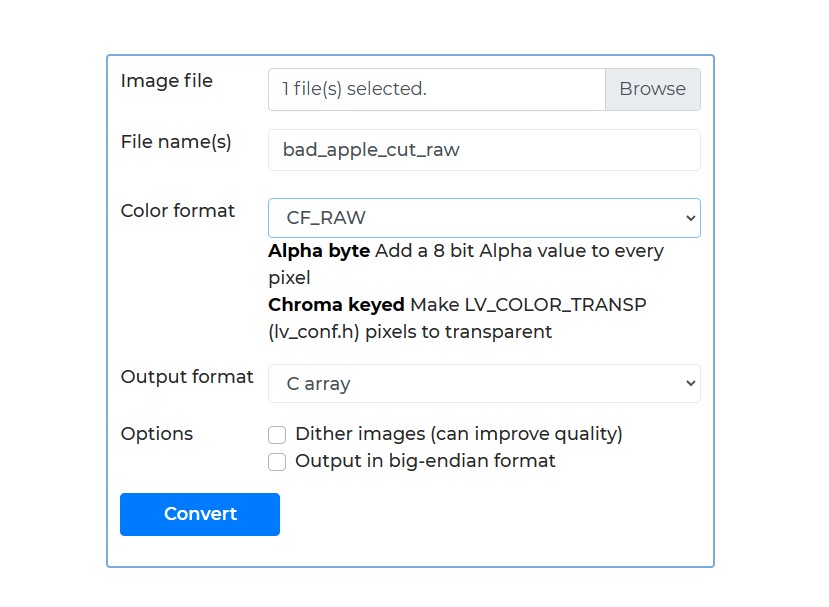

Just like what I have mentioned in the code. “bad_apple_cut_raw” is a "c file ",which I get from Online image converter - BMP, JPG or PNG to C array or binary | LVGL
I transform my gif in settings like this,

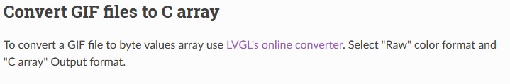

exactly the way as the offical docs says.

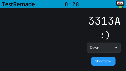

However, when I download the program and run it ,I looks like this:
Brainshot
The GIF disapper for no reason.But if I use the demo provided by LVGL Offical,it works fine.

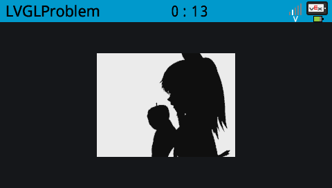

I had a look at this. First thing to do when debugging is turn on LVGL logging, set
#define LV_USE_LOG 1
and
#define LV_LOG_PRINTF 1
then you will see output in the terminal window if there are issues. I see
[Warn]	(0.000, +0)	 gif_open: no global color table
 	(in gifdec.c line #97)
[Warn]	(0.000, +0)	 lv_gif_set_src: Could't load the source 	(in lv_gif.c line #78)
so the original animated gif is missing the global color table that this decoder needs.
I hacked a version for you here. (opened in preview, exported and then had to fix the gif header slightly)
bad_apple_cut_raw.c.zip (2.0 MB)
bad_apple
