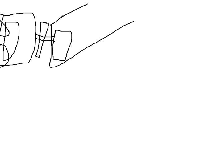

I used this style of claw ( added at competition) and it works well
I agree it has proven very effective.
Although since we did it at competion the arm would fall back down once weight ( cap ) was added. Had to be quick on raising it and getting ir on top of pole before it fell down again.
I would suggest rubber bands to help go up. combine this with a stop of some sort and you should have a pretty fast flip. I also suggest putting another motor on it if using 393.
Well where the claw itself fell down, not the arm. We had 2 motors on it
arm as in lift or as in the forks
The L shaped fork. The arm was fine but the L bracket claw thing fell down when any weight was added to it
Rubber band it to a position further up, this should help it deal with the weight. at the same time be careful not to rubber band it to much or else it will have trouble going down.
