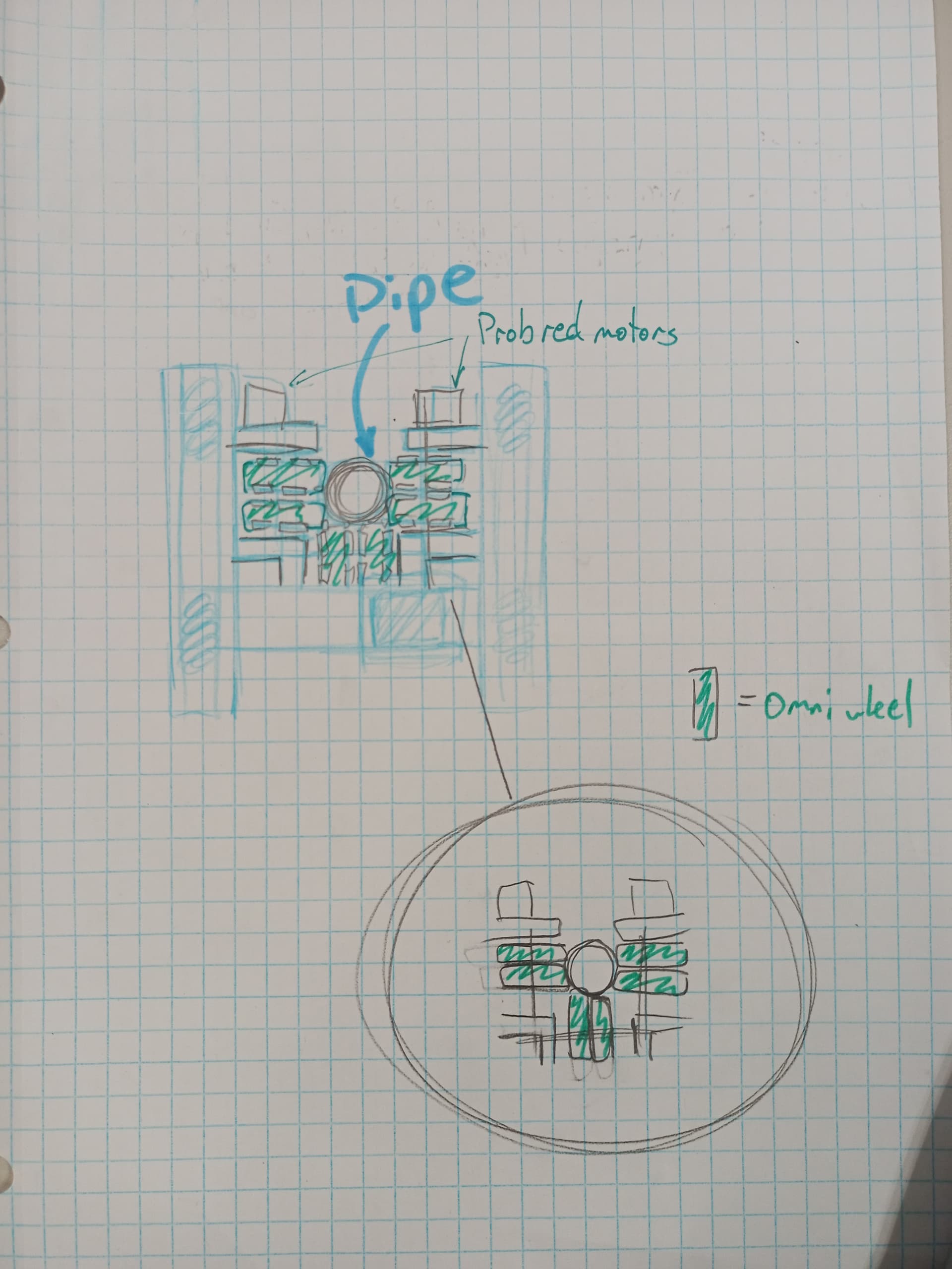

I had a strategy for Endgame where you drove up the Elevation bar. Using 3 sets of wheels on the interior of the robot and an empty opening in the front, you could just drive up the Elevation bar. However you would have to use Omni wheels so you could rotate to avoid the part of The elevation bar the attaches to the feild barrier, you also would have to have some way to wedge yourself up and above the short barrier to center yourself on the bar.

I believe flex wheels would probably work better for this.
Yes, I know;
This shouldn’t be an issue with flex wheels as long as you rotate around the pole while it climbs; the robot is moving vertically at the same time as it is rotating horizontally. I don’t think flex wheels would prevent the robot from rotating.
I do think that omni wheels wouldn’t have enough grip (if they are in the location they are in the drawing).
You could probably make omni wheels work just fine if you used some type of torque induced friction mechanism. Here are two examples:
  • Example 1:
  • Example 2:
