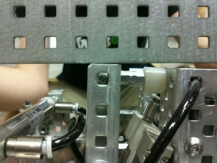

This was one of the robots from my former team at NZ Nationals, similar situation. Sure it was a bit interesting to see it get sized but it managed…

The picture I posted was not from the robot I had been working on, but the B robot on our team. I took it down the day before Nationals to get it inspected in advance for them, and it was quite a surprise, but we managed it absolutely fine. Making the lift straighter also made it a bit shorter in height (the lift was actually on a hinge at the base, similar to 1103 from Round Up, and it just wasn’t quite perfectly vertical). I’m pretty sure both the inspector and I got a fair bit of amusement about how close it was, yet it worked.
For the height of a robot it’s generally not so bad, but length, especially with fold out intake mechanisms, always aim to be comfortably in size. Too many times have I (and I know plenty others) been frustrated at how long it takes a team further up in the inspection queue to get through sizing because as they get one fold out bit up and balanced just absolutely right at the edge of the 18", a second one opens out again, and so on, and then the chassis needs to be wriggled back to be lined up… It also really slows down the match schedule at a competition when it takes so long to set up, which annoys just about everyone. This season I’ve been volunteering, I have a lot more respect for the patience required now, let’s say!
I worked on a robot that was only 12.5" wide, 17" tall, and 16" long last year, worked absolutely great. If that last bit of space can make a difference, and if you can be absolutely sure that your robot will be in size in any situation, it won’t be a nightmare to set up again, and you can test it repeatedly knowing that you won’t bug anyone at all, like the B robot picture that I posted, then I think that is absolutely fine though.
