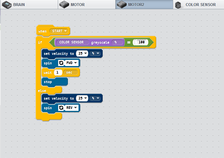

I introducing VexIQ this year to my robotics club and
on ModKit I’m trying to get my clawbot to
go forward
But
go turn back when black detected black line.
I’ve atttatched what I’ve got so far. I haven’t really detected any movement at all.
I realized now that I may need to put a forever loop around the entire script after “start.” Also, adjust my colour sensor values (but I should still see movement FWD or REV). But could someone please show me an example of a script that works and does this? Or give me suggestions?
I’ll have access to the robot tomorrow. I hope I can get an answer by then.
Yes, you will need the forever loop, after the start block. With this program, the motor may get a command to start, but will stop when the program ends, which happens right away.
With this program, if you start the robot on the line, it should move for 1 second.
Steve
