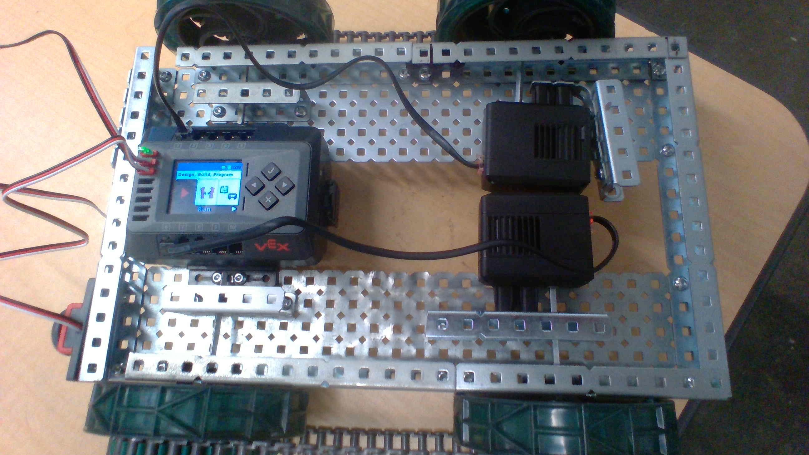

so far this is what I have and we are using VEXEXP so far this is the prototype we have yet to add the 3rd wheel
my fellow engineer friend, you must use the gear ratios lightning crashes OOOooOOoOoOoOoo gear ratiooooossss

here is the working photo

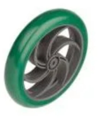

The wheels you have are not known for their high traction. If you have the VEX foam. ( looks like the mesh shelf liner from the grocery / Home Depot) wrap it around the wheels to give yo more traction.
If you found some wheels like these it may have better traction on regular floors
But aside from that, looks good
That being said you should watch out for build quality try keeping everything square and adding triangles using standoffs anywhere you can for extra support
