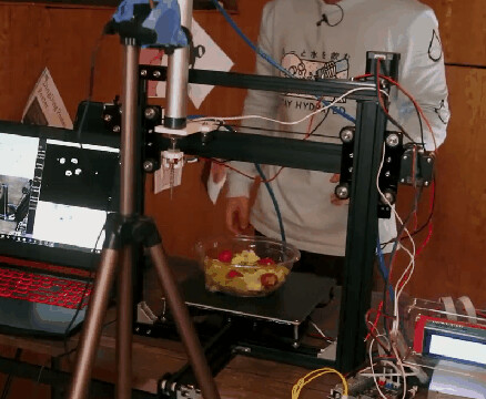

Im gonna make a Big metal piston spike machine
pretty much this, but for plastic bottles to punch holes in them so that they could be crushed for a school project where we are making a machine to sort, crush, and dispose of plastic bottles and soda cans, do VEX pistons have enough force to do that?
