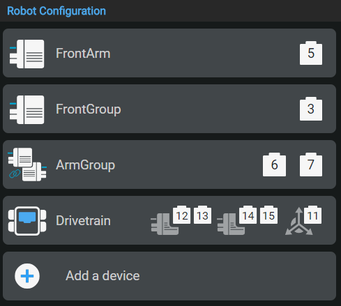

I'm using inertial sensor in the drivetrain in my code but i want to use inertial specifically
As i mentioned in the title, how can i do this in my code, i’m using vexcode pro v5.
When you configure stuff in the config window, VEX generates code to actually configure it in the code, and (I think) hides it at the top and says don’t touch it. If you copy and paste all the stuff that’s automatically generated, I could probably help you. (Put ``` on the lines before and after your code so it formats properly.)

Otherwise, when you add the inertial to your drivetrain config, do inertial sensor commands get added to your command menu? In IQ, we can drag the commands from the menu and it will automatically fill the name part with the name of our real sensor, i.e. when we drag Gyro.heading() from the menu, it will appear where we drop it as Gyro7.heading() or whatever our gyro is named. If you drag an inertial command from your command menu, maybe it will fill Drivetrain.Inertial or something.
robot configuration
And Drivetrain.Inertial doesn’t work :frowning:
Try
DrivetrainInertial
You can bring it into your main.cpp with the extern command.
