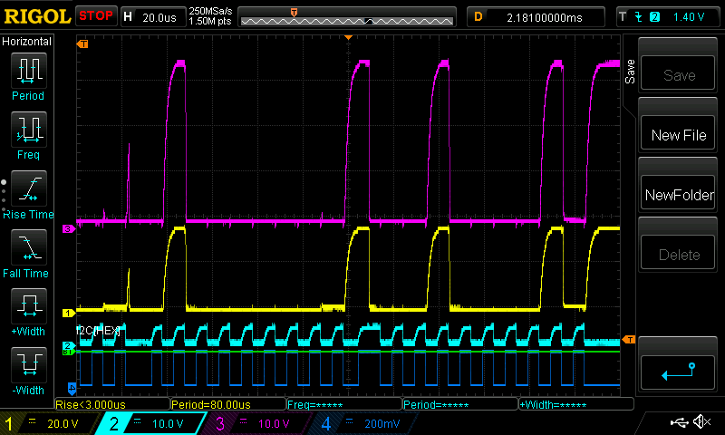

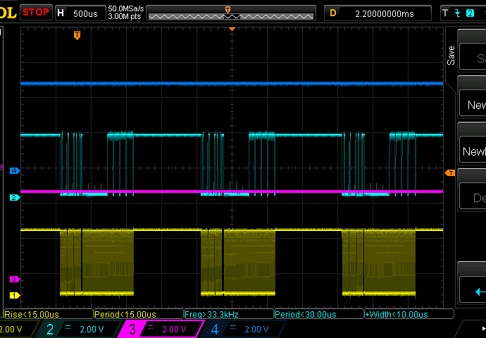

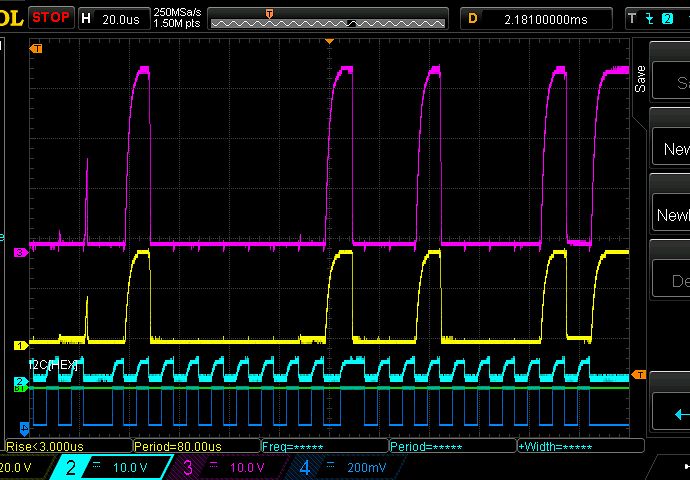

I briefly fell into this problem a couple of months ago . At the time I though we had fixed it, but we started having problems with IME’s failing to initialize properly the week after. I finally received some time to set down and start to debug and I have somewhat tracked it down the the Analog switch connecting the SDA and SDK lines. As when I look at it on a scope there is no active on either line when this problem exists http://imgur.com/a/8hToE This issue is common enough that we encountered it every competition and once it starts it seems that the only fix to let it sit there for a while. The easiest way to trigger this event is to switch the brain off as soon as it starts to turn on. It will probably take a couple of attempts, but it should happen eventually. I know that this is an edge cause, but we’ve found that it is relatively easy to concurrence during competition as there are sometime intermediate power interupts from crashing around and other issues. Whats really weird about all of this is that when looking at the LED codes on the IME’s the second IME seems to believe that it has a valid address and double green blinks even in this error state. I am way over my head on this one so hopefully with the information I collected someone will be able to take a better guess at it than me. If it is important we are running the latest version of Convex.

@jpearman Just to throw a little more light on the behavior the fastest way to induce this behavior is to boot everything up then unplug an IME in the chain and replug it in (I know this will cause problems, but when we have issues the problem arises itself.) Also when this becomes an issue by itself the IME will work correctly for a few seconds or until the remote establishes connection with the cortex whichever is first.

Yea I stripped the code all the way down to the example code . The only thing there is that the motor array now has the IME code in it. After some more testing it definitely happens when the controller connects to the cortex. I let it run for ten minutes and it was all fine, but as soon the controller connect it will sometimes drop an IME.
