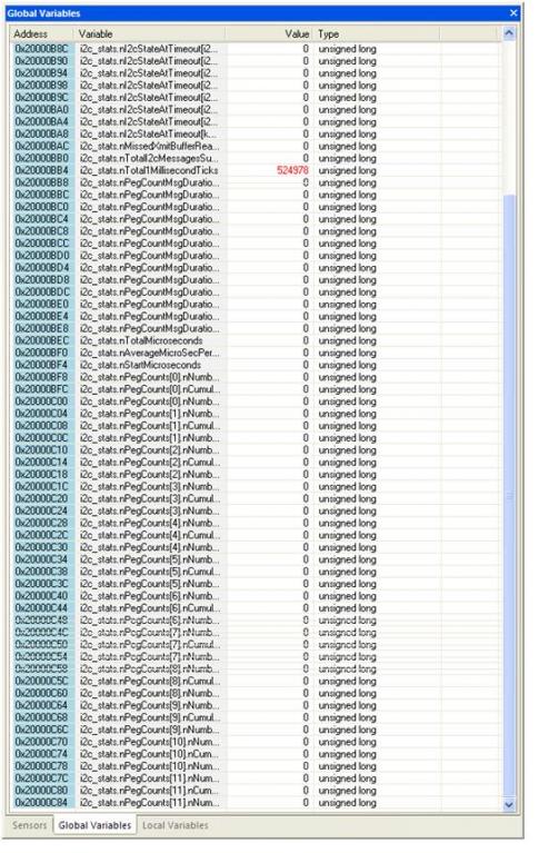

Another thought as you are trying debug code, add this global variable to the beginning of your code.
TI2cStatistics i2c_stats;
and then update that variable in a task like this.
#pragma config(I2C_Usage, I2C1, i2cSensors)
#pragma config(Sensor, I2C_1,  ,               sensorQuadEncoderOnI2CPort,    , AutoAssign)
#pragma config(Motor,  port1,           motorA,        tmotorVex393, openLoop, encoder, encoderPort, I2C_1, 1000)
task I2C_Stats()
    while(1)
        getI2CStatistics(&i2c_stats, sizeof(i2c_stats));
        wait1Msec(10);
task main()
    StartTask( I2C_Stats );
    while(1)
        wait1Msec(10);
Then when the IMEs freeze take a look at the globals window in the debugger, it will look something like this.
[ATTACH]7413[/ATTACH]
If you can get a screen grab and post it back, I’m interested in seeing where the errors are, message being sent etc.

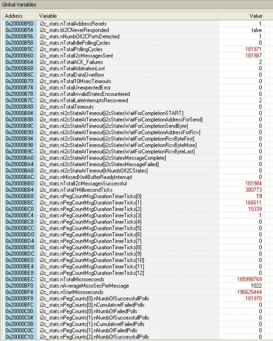

Okay it just happened again!
so the lights are all doing single flashes of green except for the last IME in the daisy chain which is doing doubles of green.
Here are the screen shots you wanted are attached.
We have not changed that IME or wire yet but we can now.
The rev is A3.
Well that shows they are all initialized corectly, single or double flash is the difference between terminated (last IME) or not terminated.
If these are correct, it shows that ROBOTC is not even trying to communicate with the IMEs, the nTotalPollingCycles and nTotalI2CMessageSent should be counting and not 0. Did you have to connect the debugger after the failure to get this information or were you already in the debugger when they stopped working? When the IMEs are working are all of these variables updating correctly? Did you use a task to get them like I had shown?
