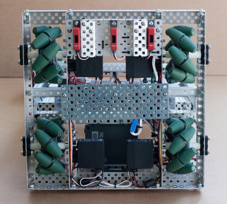

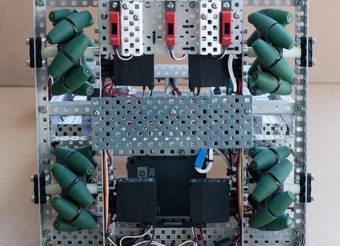

If width is the issue with adding the quadratures to your base you can do something like this.
http://sbdrobotics.com/wp-content/uploads/2013/04/photo-1.jpg
interesting mount :slight_smile: do you mind if i borrow the picture to show my team? thanks for the help
By all means, were happy to help!
