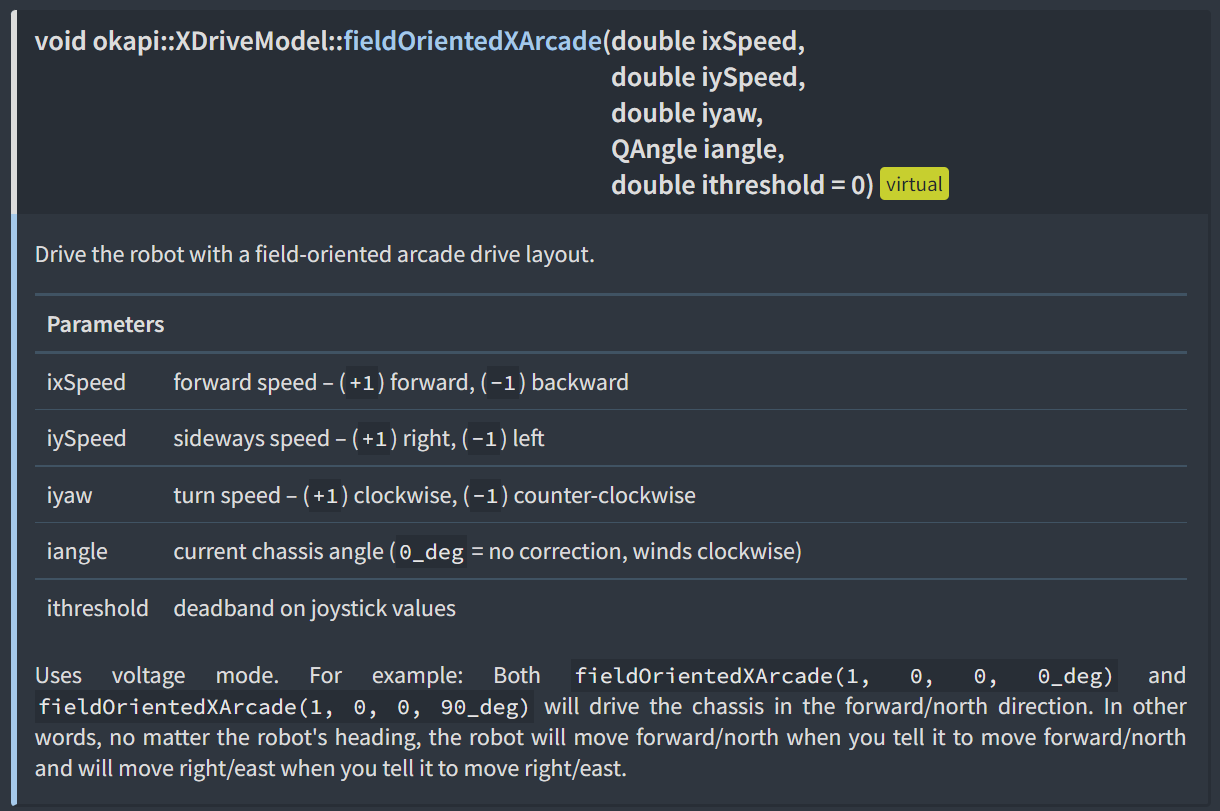

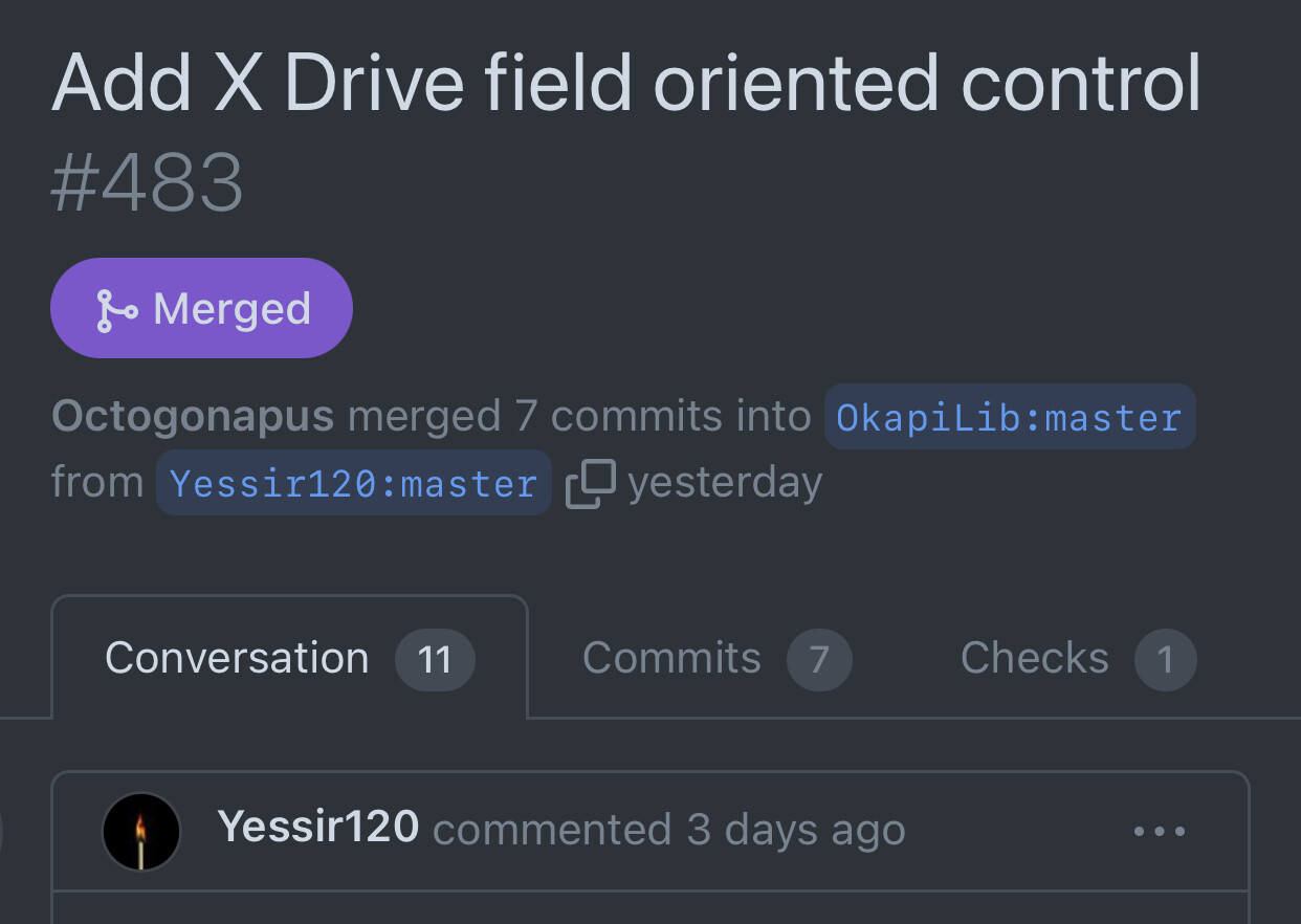

Also, Okapi recently added field-oriented control to their API as seen here:
So you can use okapi to code the field oriented control by doing something like this:
std::shared_ptr<ChassisController> chassis = ChassisControllerBuilder()
    .withMotors(INSERT_MOTORS)
    .build();
std::shared_ptr<XDriveModel> model = std::static_pointer_cast<XDriveModel> (chassis->getModel());
while(true) {
    model->fieldOrientedXArcade(LEFT_Y_AXIS, LEFT_X_AXIS, RIGHT_X_AXIS, IMU_ANGLE)
    pros::delay(10);
shameless self plug?
On a side note, don’t think you’ll need the static pointer cast. The chassis should already be built with the correct model if you give the motors correctly.
