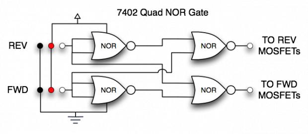

Well after a little tweaking I managed to get the circuit working and the voltage is opening and closing the MOSFET. Now the other thing I need to know is whether there is a way to ensure that the MOSFET completely shuts down, or that the signal is off before the other signal is sent. Is there some sort of fail-safe device or code I can put in my program?
Cool - congrats!
If you want to do this in hardware (the most fail-safe), you can use some logic gates to ensure that you don’t activate both the FWD and REV MOSFETs are the same time. Here is an example schematic using a single 7402 (or 74LS02) chip:
[ATTACH]1251[/ATTACH]
You can do the same type of thing in software, but given the amount of power that would go through your H-bridge if you hit a bug, I’d recommend that hardware approach.

Logic gates…haha my worst enemy. Thanks for the info! I will try and make sense of this. Do I have to connect any pins together?
I chated with digikey last night online, and I got this circuit figured out… I will order the parts on monday… We will just need the data sheet to the chip and it will work out!
One thing I noticed after looking at this logic for a little while is that if both forward and reverse outputs are turned off will both the MOSFETs turn on resulting in a dead short?!?!?!
Or because there is no power from either signal then there is no power getting through the chip and going to the MOSFET?
Just want to check on this
wow that was what I call stinkin thinking if both of them are off at the first set of gate that outputs a 1 which locks out both of the second set of gates… the only possible way this can turn on is if one is on and the other is off…

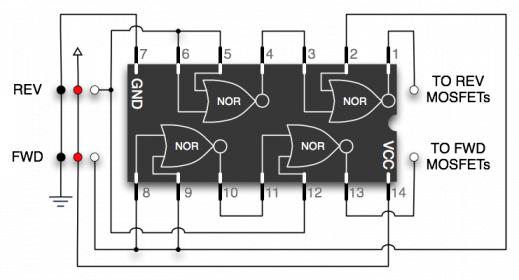

Here is the diagram showing the chip pinout. Most of the connections are pretty simple (since the gates in the chip are arranged just like the gates in the schematic). Pins 2 and 12 are the “crossover” pins that lockout a MOSFET if the opposite input is on.

Thanks… that is what we needed was the pin assignment. Funny how chatting with Digikey for a half hour I learned more than an entire quarter of College electronics class:mad: Guess that is what you get with a very bad prof.
