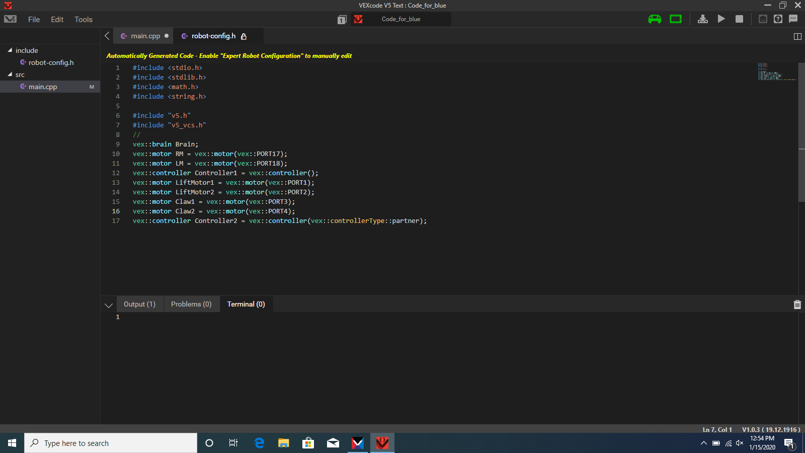

How do we edit the confiq after we import from VCS.
This is the screen and message that we receive when we upload from VCS to text based and we cannot alter the confiq and do not know what options to change.
Any advice jpearman
Hm, perhaps rename robot-config.h (and then change the reference in main.cpp). Looks like VEXcode thinks that is read only file. VEXcode will not make the graphical config available for imported VCS projects. Alternatively, create a new project (you can have multiple projects open at once) and just cut and paste the code over.
