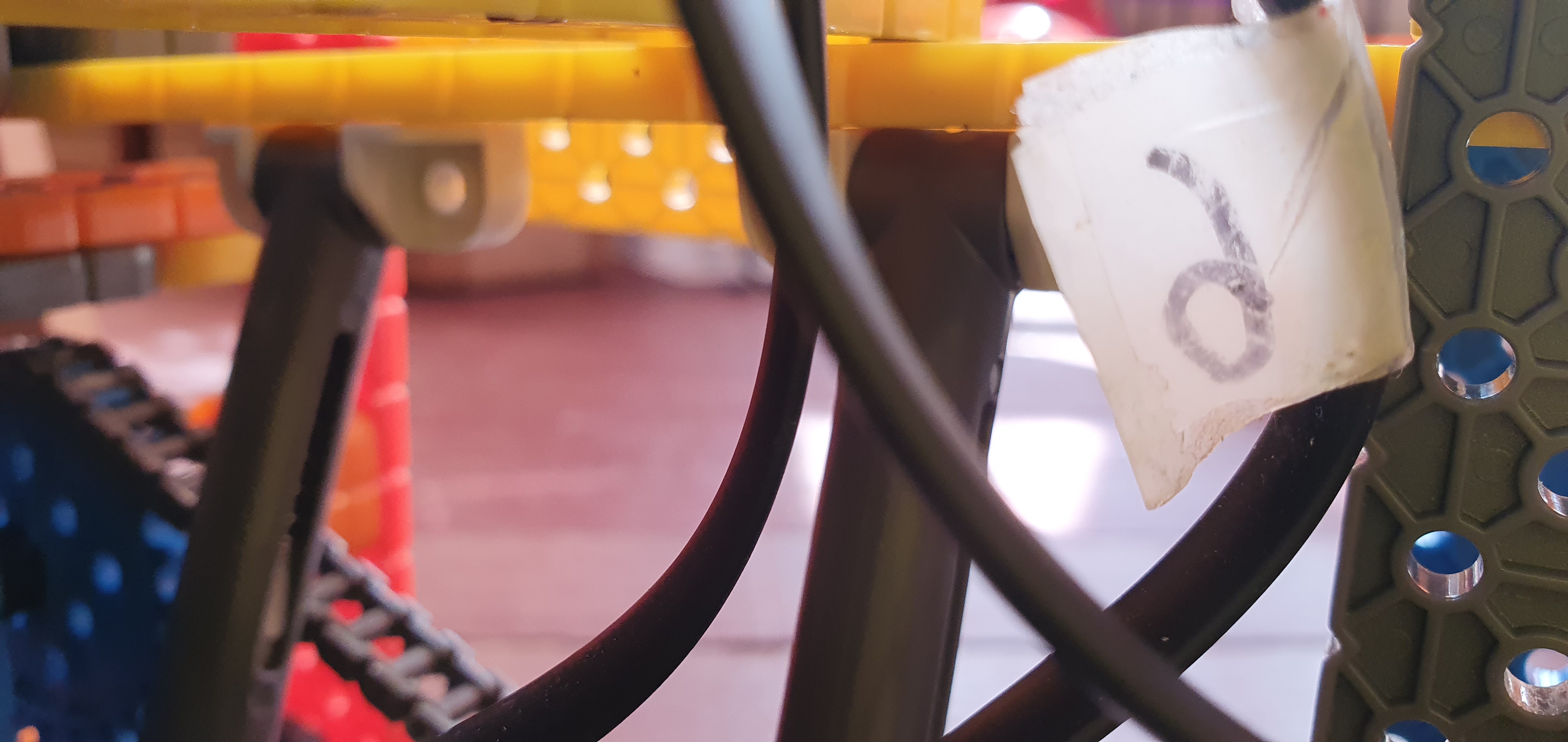

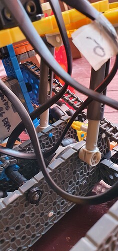

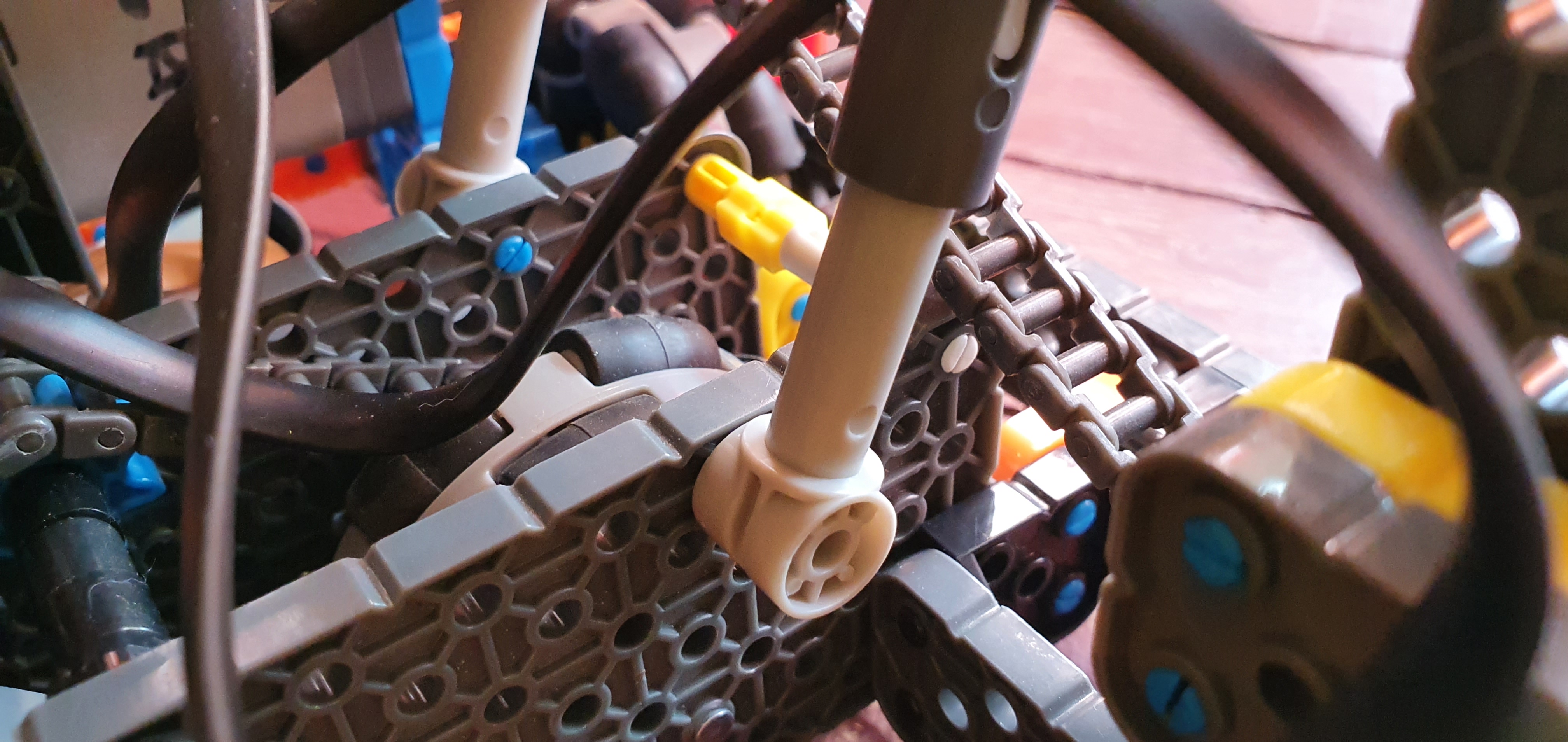

This is the link to footage of my new H-Drive. It uses shock absorbers to reduce slipping. This is the new 409B channel.
It uses shock absorbers seen in the thumbnail to apply pressure onto the wheel, which makes sure it never loses contact with the floor. The gear ratio is 1:2 for torque.

Which shocks did you use?
Can you post how you connected them?

I used the light gray shock absorbers.
Yeah, sure.
20201005_123217
20201005_123229
20201005_123221
Nice, thanks for the updated pictures.
