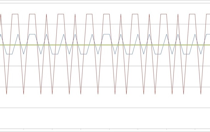

We only have one piece of information coming from the motor, the current encoder count (I’m assuming an IME for this discussion and ignoring the fact that in some programming environments the IME can indicate also give velocity). The only way to calculate speed is to use the change in encoder count over time (we know v = dx/dt).
A 393 motor with standard gearing will give 627.2 counts per revolution (I’m going to use 627 for the calculations). This sounds really high, however, lets suppose we want the motor to be turning at 10 revs per minute, that would be 627 x 10 counts per minute or 6270 counts. In one second this will be 6270/60 or 104.5. We could calculate the motor speed every second by reversing this calculation speed = (104 * 60) / 627; speed would be 9.95 rpm.
For the motor to be successfully controlled we need to know the speed much more often, I’m running the speed control PID loop every 25mS (40 times per second), so the number of counts when the motor is running at 10rpm is 6270/(6040) = 2.6125. The encoder does not give us an encoder count as a decimal, the change in encoder count every 25mS can either be 2 or 3, it will average out to 2.6125 over a long period of time but the instantaneous change can only be 2 or 3. If the change is 2 then speed will be calculated as (24060)/627 = 7.65, if the change is 3 then the speed will be calculates to be (340*60)/627 = 11.48, start to see the problem.
If we plot calculated speed vs time with the motor running at exactly 10rpm the graph would be as follows. The green line is the actual speed, 10 rpm, the red line is the speed calculated from change in encoder position, ignore the blue line for now.
[ATTACH]8484[/ATTACH]
The error in speed calculation causes the PID controller to fight the motor when it doesn’t need to. As the speed decreases this situation gets worse, at 1 rpm we only see a change in encoder count every 100mS, above 10rpm things improve but even at full speed the calculated speed will fluctuate. So somehow we need to improve this and really the only tool available to us is to filter this signal somehow and remove the spikes. I decided to use a simple 4 sample low pass filter of the encoder count change (sum the last four delta values and then divide by 4) rather than filter the calculated speed as this gave a better result. This improvement is plotted as the blue line on the above graph. The calculated speed swings between 9.57 and 10.52 (which when I round to be an integer for subsequent calculations becomes 10 and 11), a 1 rpm error rather than a 4 rpm error should be ok.
