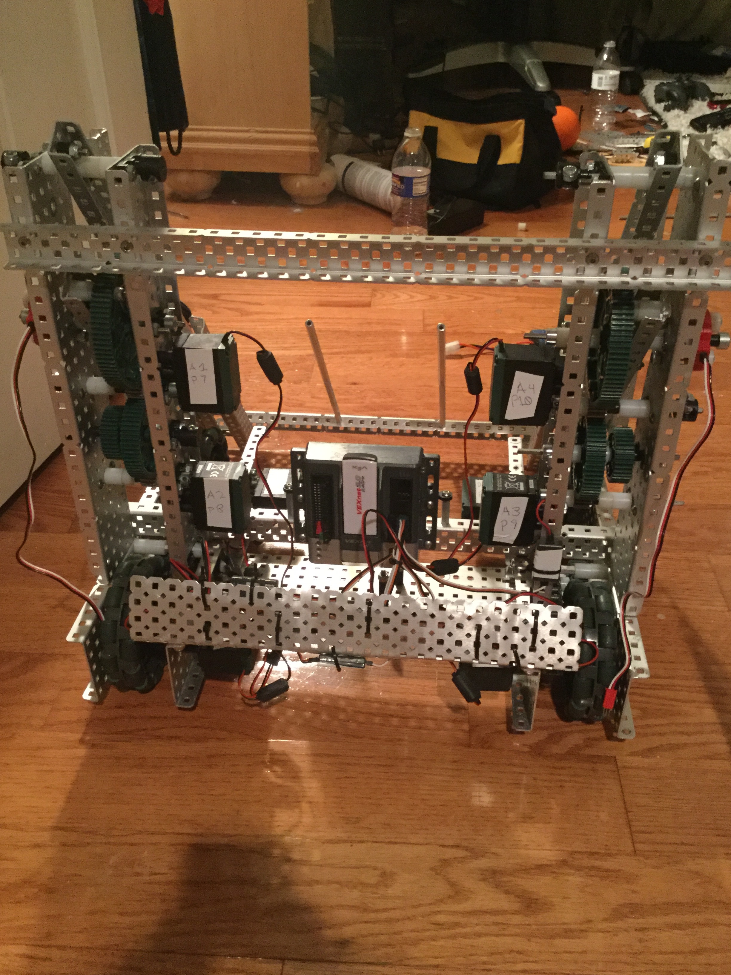

So what about wiring the cords to the cortex? Any tips on that other than ziptiing the motor controllers to the metal? I’m probably the worst at doing it but the picture will show where I need improvement.
A couple of examples.
Gallery
They would both make a field tech at worlds happy.
  • Good visibility of the leds.
  • Power switch easy to access
  • VEXnet key not obscured by metal.
  • Battery not hanging off and dragging on the floor.
On the first, I would add structure near all the sensor wiring for strain relief. Example 2 is awesome in that regard. Both are nice cable management. Personally I like the second one better de to lots of protection to the cabling around the cortex.
