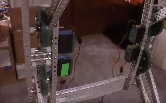

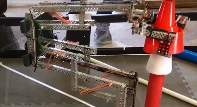

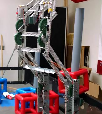

What are some common lift gear ratios for tall lifts such as DR4B. I am thinking a 5:1 for torque would be ideal, but I am not sure.
After scrounging the internet, it seems like 1:7 is the way to go.

Double Reverse Four Bars lift at twice the speed and half the torque of a single four bar, so your gear ratio seems a bit too aggressive for lifting the goals.
The way I made mine lifts the exact same way a 4-bar would
Well this gear ratio is just a little faster than 5:1 with torgue motors if you convert the 1:7. It is with speed motors, so converted to speed with torque motors = 7 / 1.6 = 4.375, so ratio = 4.375:1.
I think that though with enough rubber bands you would be able to lift them fine.
If you have a 1:7 with torque, tensioned with bands for speed, it should be fine I would think. If it’s too slow, I would consider going to 60’s or keeping the 1:7 with high speeds. We’re not allowed to test yet so we’ll figure out in a few months.
What does “tensioned with bands for speed” means? As far as I know, one put rubberbands to make a counterweight for the lift.
More or less that.
Did anyone think about a 1:5 with high speed internals and rubber bands?? That might be enough because its not that much weight and this ratio will be a lot quicker.
That’s actually what I was thinking, if 4 HS motors with a 1:5 external gearing could lift a bunch if starstrucks…

I know that. I want my lift to be fast, but still hold a lot. That’s when rubber bands come in
I feel like this might be a bit too aggressive, but it’s worth a try. The issue with this might end up being that you have so many rubber bands that the arm struggles to come down rather than go up. I have actually seen a few robots that struggled to lower their arm because of the intense amount of rubber bands.
Ok. I just wanted to point out that they are pretty close to the same ratio, so if one doesn’t work the other might be a good choice without sacrificing too much.
Wouldn’t it make more sense to take 2 motors of the lift and use them elsewhere? Make a 2 motor linear lift to just pick up mobile goals maybe, that way you get speed for cones and torque for mobile goals. Then do a 1:5 on the lift.
Is it possible to do an effective/efficient DR4B with only 2 motors?
Maybe not a 2 motor 1:5, but a 2 motor 1:7 should be easily doable. Teams in skyrise lifted 12+ times as much weight with 4 motor 1:7s.
I still feel that 2 motors would be too little if you wanted to make it very durable and fast.
