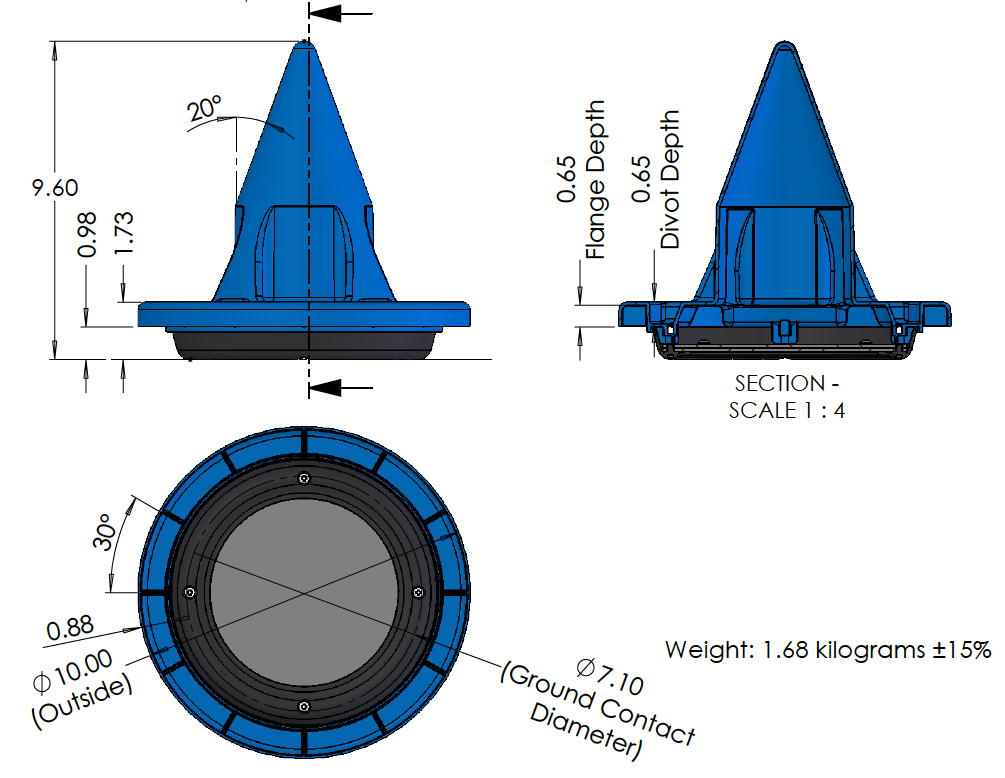

Sorry, but could someone tell me or post a picture of the bottom of a mobile goal?
A mobile goal is the larger cone thingy, that you stack the cones on, and pick up and move into scoring zones.

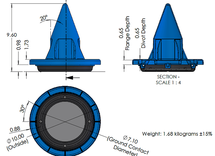

No, what does the BOTTOM look like?
Not sure if this helps too much but this is what i found

its sort of a thick disk… see @RoboCrazy101 's diagram for more info
And it is heavy 3.7 Lb
3.7 lbs! that is heavy…
I guess from my view, 3.7 lbs isn’t that heavy when compared to the 10 LB goals from Round Up.
