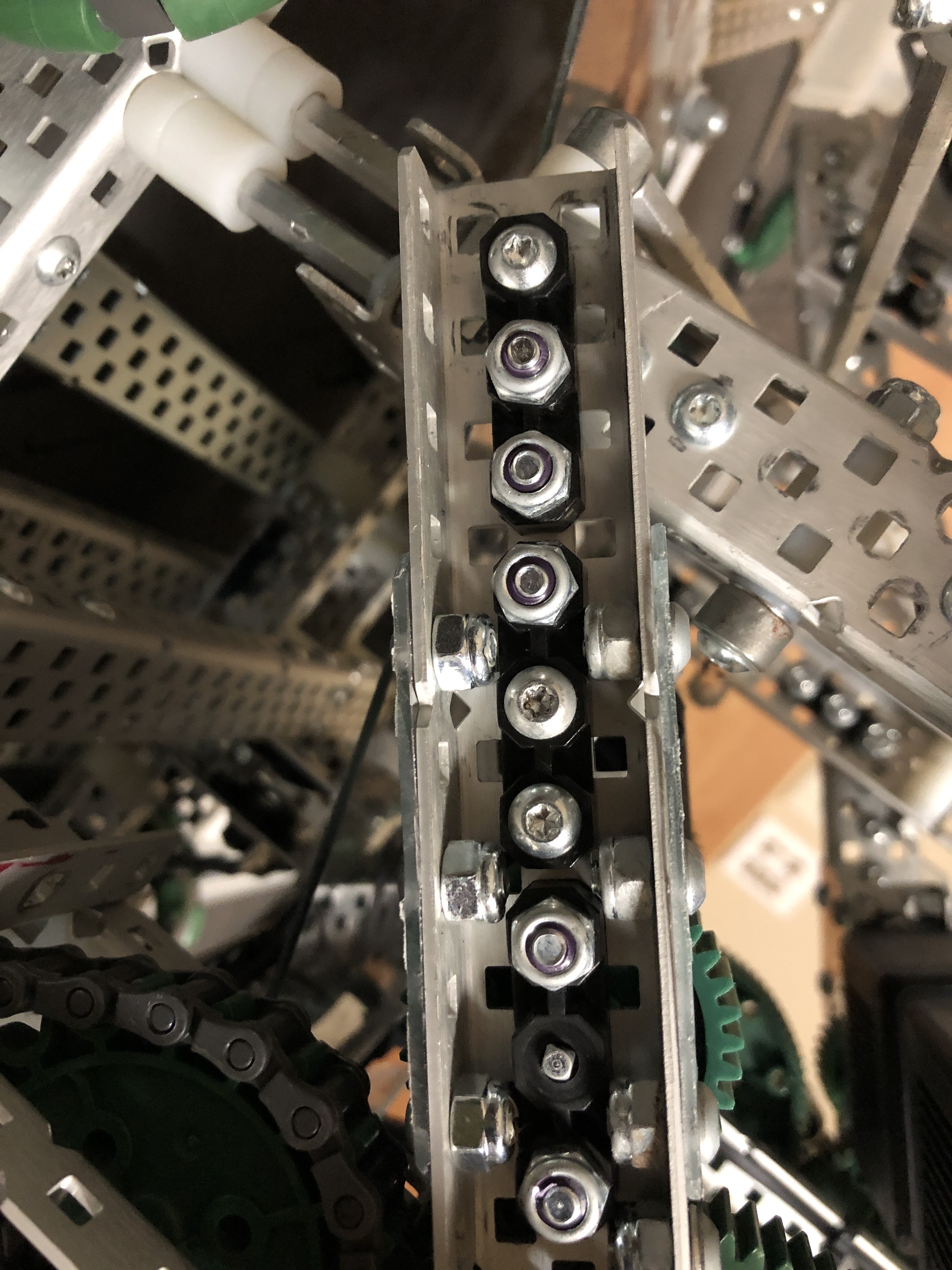

Yes, rivets do not fit the vex bearing flats holes perfectly, and cause a lot of slop. We as a team like using the 0.5in screws for bearing flats, along with thing nylocks.image
Edit: This is an example from our prototype for this years competition.
