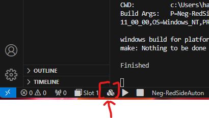

You can find it here after you build your project:
Its possible that the project could still build and its just an intellesense issue cause by a change in the c_cpp_properties.json file. In order to determine whether its a build error or intellesense issue, I need to see if your project builds.
You can build your project clicking the following button in the toolbar.

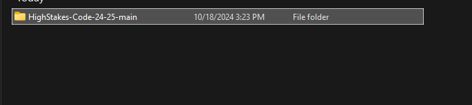

So did you open up this folder in vscode,
HighStakes-Code-24-25-main which is the top level folder located in your repository.
Or your project folder in vscode,
Neg-RedSideAuton
Make sure you open the folder named ‘Neg-RedSideAuton’ within vscode
If you open the wrong folder, vscode won’t be able to properly resolve your includes because it can’t find the c_cpp_properties.json file located within the .vscode folder.
I have been opening the code from the top level repository. After opening it from the folder named ‘Neg-RedSideAuton’ I am not getting any of the include path errors, but I am still unable to build the code.
