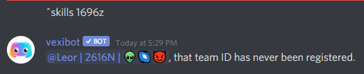

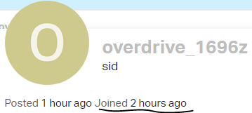

My troll detector is going off hard here - brand new account, pretty nonsensical post, team number that doesn’t exist…

Looked it up, says their a registered IQ team.
https://www.robotevents.com/teams/VIQC/1696Z

I agree it is suspicious, but the number is an iq team that qualified for worlds last year so he is probably legit. I agree that vex system isn’t the best. I also agree the programming is a challenge. After all, if everyone could just input distances using vex’s drive train then almost everyone could have a home row and there would be no fun.
