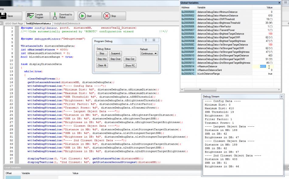

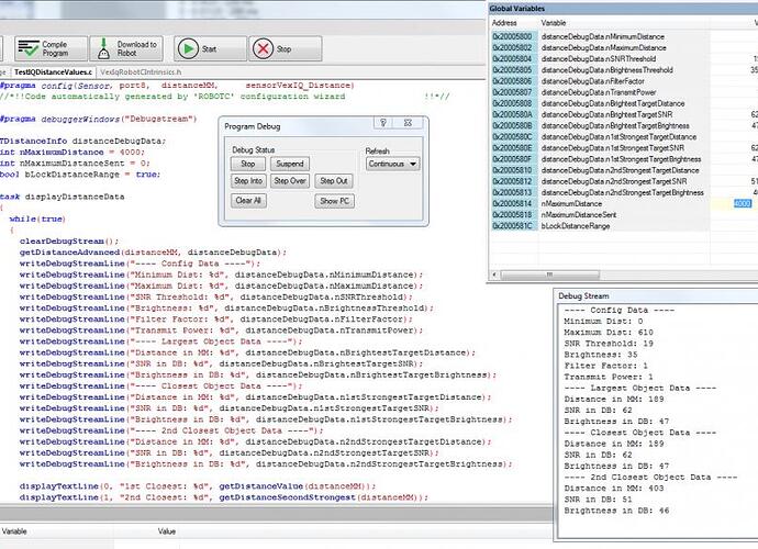

Lastly, here’s the program I used to debug/diagnose the distance sensor - along with some interactivity… you can use the “Global Variables” debugger window to set “bLockDistanceRange” to false, and then use the “nMaximumDistance” variable to adjust the maximum dynamically in your program. It’ll output all of the requisite information on the debugger screen and also the VEX IQ LCD.
Note: To modify a global variable, just click in the “value” column for that specific variable and type in a new value and press “enter” (or click away from the text box) to send the new value.
