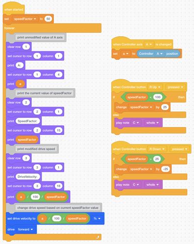

I am trying to increase the speed while driving with a controller. Is that possible? Or is it already at 100%. It takes forever to drive from one side of the field to the other. I know how to do it with autonomous. I am not sure what the % the speed is set to with the drivetrain using the controler. Here is my code.

It all depends on how the joystick is programmed. If you are using the built in drivetrain functionality, the moment you push the joystick forward you overwrite the velocity to the stick position. What you need is to code the joystick yourself and add in a derate multiplier. Your toggle (R up for example) will change your derate multiplier.

It is VEX IQ blocks.
This is the best I could come up with for you. It allows you to drive at 25%, 50%, 75%, and 100% speed. You increment the speed factor by pressing R-up, and decrement with R-down. It doesn’t work how you describe (changing the speed WHILE you hold down a button, and changing back when you let go). I think that functionality would be awesome…I just can’t figure out how to code it. I created a separate thread for that specific functionality because I think it would be extremely useful. Great idea.

@hpeace - I spent some more time playing around and mostly figured out a decent solution, I think. See that thread here: Change function of joysticks using modifier button?
Hope it turns out to be helpful to you too!
