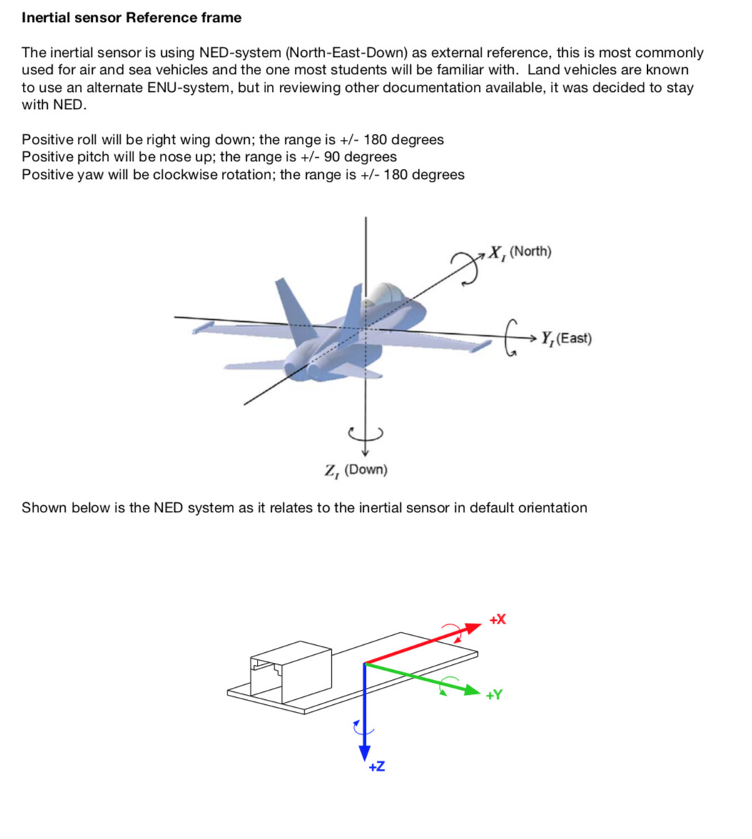

Choice for the IMU was NED. The old yaw rate gyro was the same, that’s why default is turn type right.
For any sort of math-related stuff you’re going to have to convert heading to an angle system that works with your localization coordinates. This usually means CCW-positive, and most existing libraries do this already.

To be honest, its kind of painful dealing with NED (Z-down), since it doesn’t work with cartesian coordinate systems by default, especially when VEXCode’s drivetrain APIs teach people to think using these angles… It’s been a point of contention in LemLib’s development, which started with NED angles for public APIs but converted them internally, resulting in a mess between user-facing functions and internal stuff with incompatible angle returns.
There’s also conflicting axis labeling (notice how the first set of images are Z-up) on VEX’s official documentation which doesn’t really help the confusion either :stuck_out_tongue:
